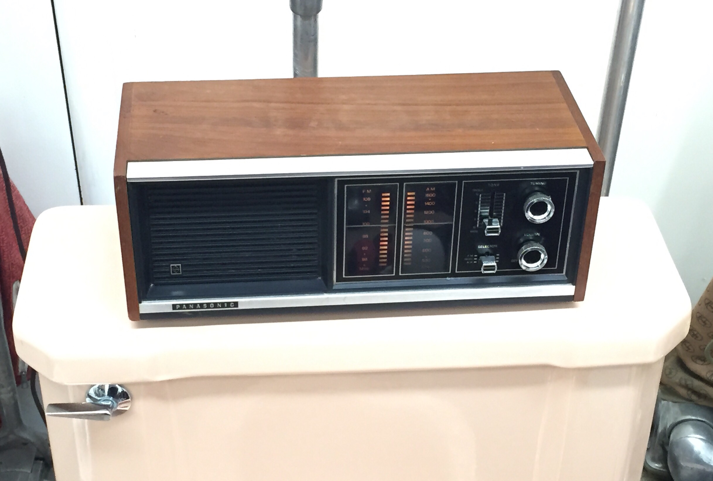

I was at an estate sale today, and I saw this real nice Panasonic RE-7371. It was just begging me to take it home, and for $10, I just couldn't pass it up. It's in excellent condition, and it sounds beautiful. It's pretty nice to be in the FM world again, too.

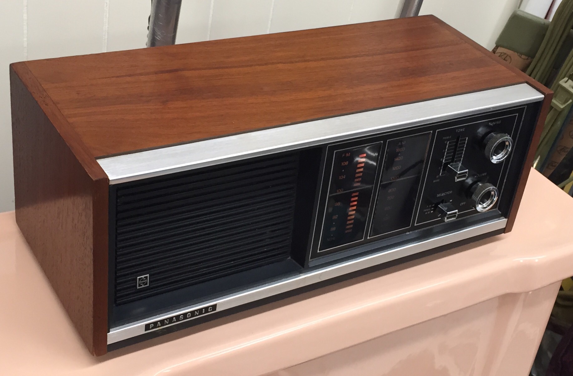

I hit it with the old GOJO Creme, and YOWZA! That GOJO Creme made it look like brand new!

Is there any particular reason why when I click this radio off, it blasts the station back at me for about 2 seconds and slowly fades away? Sometimes it changes stations during the fade. It works great, but this is getting annoying. The blast is so loud, it can be heard on the other side of the house. I'm scared it's going to hurt the speaker if it continues.
Slave to an RCA Victor CTC-25
 First of all it is not from the 1960s, probably more like the early 1970s, before 1970 the Jap makes used to mark the dial frequencies in KC and MC not KHz and MHz, if you open it up you may find some date codes that will narrow it down. As for the other issue with the volume blast when you turn it of chances are it needs the electrolytics changed and maybe a few resistors by now.
