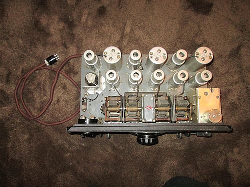

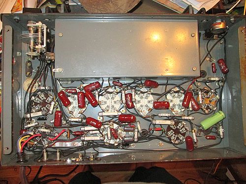

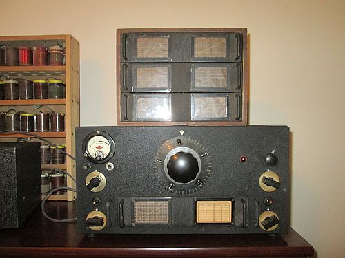

Here's a few final pics. I had a lot of fun getting this guy back in good working order. And am looking forward using it as a station receiver in studio B (up stairs ham shack). Will be constructing a power supply for it, have been using the one for my 2 toob regen. I don't have an original spkr/cabinet for it but do have a universal metal spkr from the '30s and hope to be able fit the p/s inside it.
Will probably revisit L76 when I get studio B put together. Mike, no not you, the Mike with a license maybe when the summer static clears out a bit we can get together on 75 or 40mtrs.

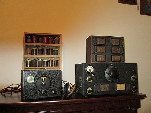

ps. It told me it wanted to hang out with it's little bro a 1936 or so SW-3 w/a few coilz.

The electronics was fairly straightforward barring the broken wire on the volume control and an odd taper RF gain control. Last fall a ran into an old National chassis with lots of dud paper caps in it. They have been cleaned up and are ready for new innards.

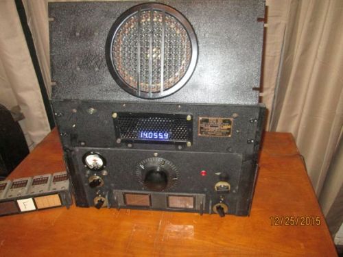

I finally got the digital readout to work properly on this beast. I started out using rectified heater voltage to power it but it didn't like it much at all. Worked much better w/a 9v battery.Ended up building a 12vdc p/s inside the rack p/s to power it. As Mondial said it is pretty sensitive so I had to attenuator the oscillator signal. Wasn't quite sure what is grounded on the counter but signal - power - and the mounting hardware had no interconnection. Grounding the power - to the chassis helped a lot and bypassing the 12vdc w/a .1 cap got it to settle down nicely. Works great now from 500kc-30mc. Haven't tried any of the low frequency coils yet.
I'm pleasantly surprised at how stable this old guy is after in little warm up time and the counter proves it.
