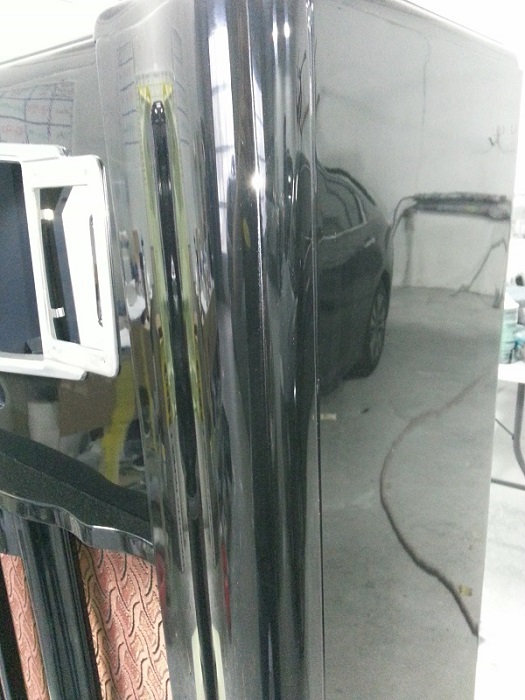

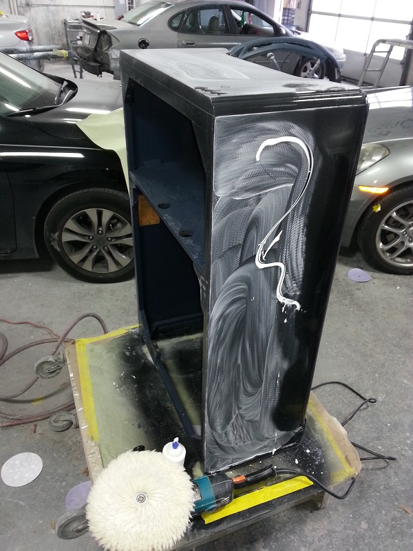

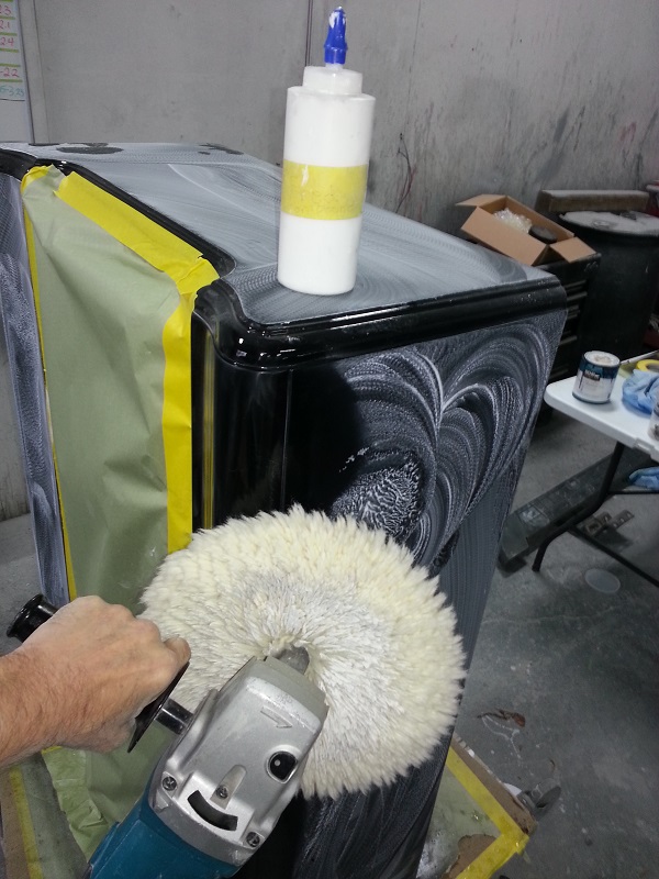

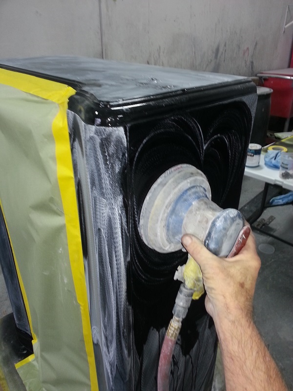

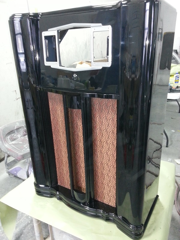

The zenith 10s669 is coming along nicely, cabinet has been painted black lacquer and clear coated with gloss piano clear lacquer. Now I am wet sanding and polishing out in the photos. The wood face control panel was painted and rubbed out seprate from cabinet to allow for best results on finish and rubout. The radio chassis , speaker and loop antenna were serviced, speaker was repainted and box cover for loop antenna was redone as well and will be seen in next post of completed radio. Thanks for looking.
