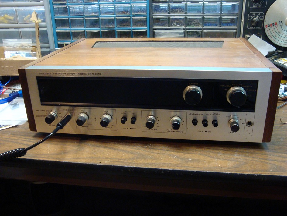

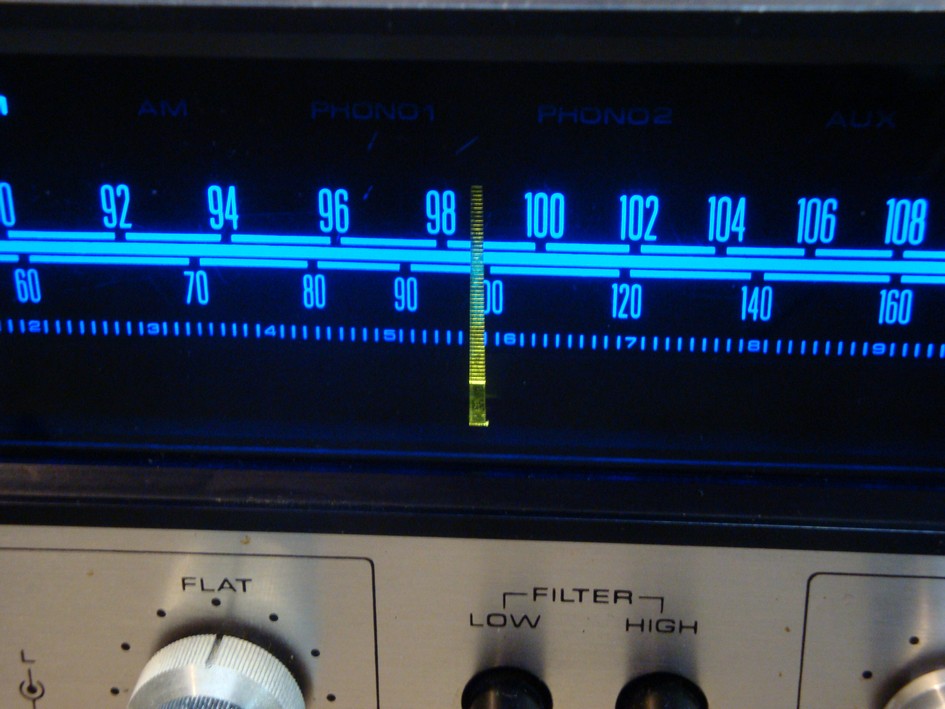

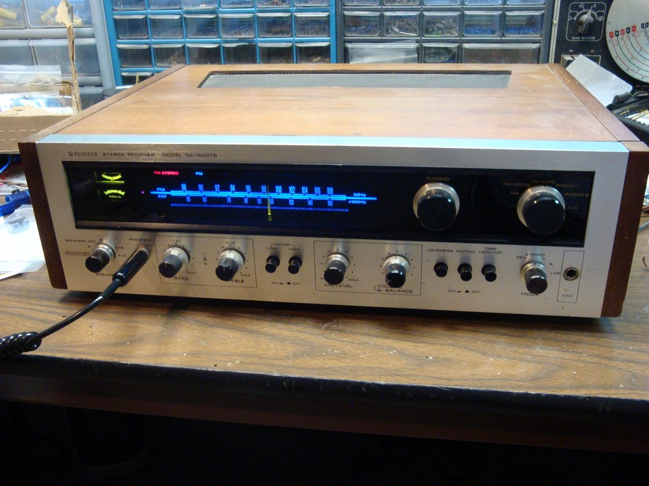

Photos:
[Image: http://www.philcoradio.com/images/phorum..._00029.jpg]
[Image: http://www.philcoradio.com/images/phorum..._00030.jpg]
[Image: http://www.philcoradio.com/images/phorum..._00031.jpg]
The dial pointer goes out when the receiver is in PHONO 1, PHONO 2 or AUX mode (but the dial remains lit).
I'll post a circuit later showing the entire LED conversion.
