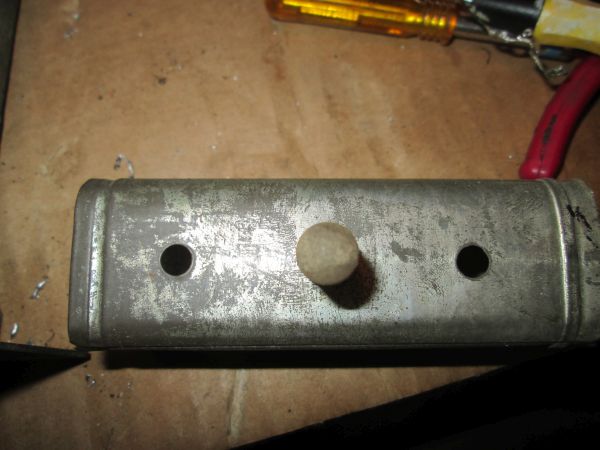

Spun the chassis around to have a look at the dial mask and cap drive system. One of the reasons the dial was dim was:
    That's the front of the dial lamp.

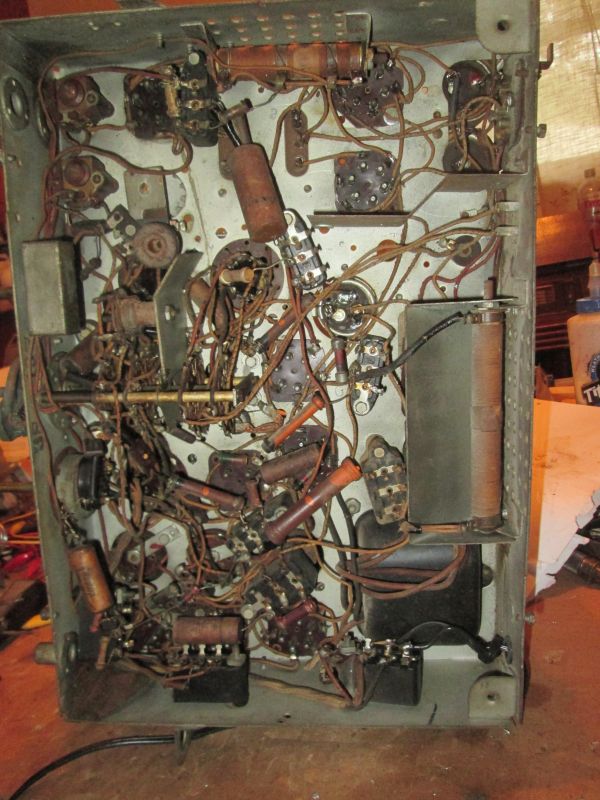

Here's a few pics of the under side with the e caps rebuilt and the 42 socket replaced. Looks a little tidier as there where some old repairs (connecting new caps across the old) that are gone now.
Am waiting on an order from Sal's to come in with needed mylars. Should be here soon. Then I'll start on the Bakelite caps and resistors.
