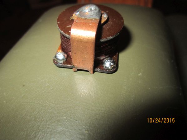

After trying to reassemble it I found two things: vane was stiff (wasn't before) and my twisty wire terminals didn't work so well (coil wire from the inside broke). So had to do some rethinking. Found some 2-56 screw/nuts from an old Command transmitter. These fit very nicely in the holes in the sm, add a little solder and now I have stationary terminals.
Adjusted the pivot tension on the vane and it seems ok. Vane has some white corrosion on it but I don't think I can get in cleaned up w/out breaking it.
Onward to reassembly! Again.
