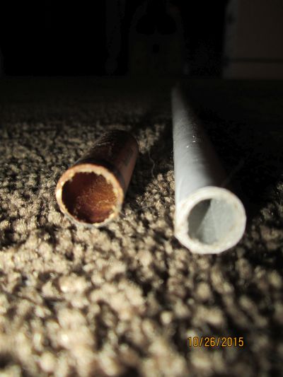

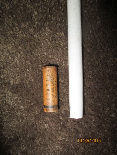

Arran Wrote:One thing that I have been looking for are sources of smaller diameter cardboard tubing in order to make replica capacitor shells.
Back when I was working I was wearing company supplied uniforms. The pants hangers used a cardboard tube to support the weight of the pants. These tubes are just about perfect for making new shells for replacement caps. An old tube from a Sprague .1 600v is within a mm or so. New Mylars fit easily inside even though the wall thickness is bigger. Each tube is long enough to make about a dozen shells.
