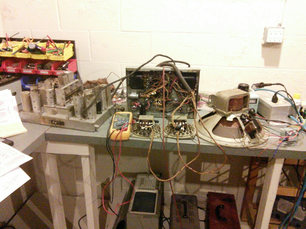

As I also need the tweeters connected I took them off.
The cones aren't good. Though electrically both are ok. One is patched and one is warped - likely water.
Well, after the power-up with no sound......the interstage transformer is also shot. Also the primary. Open.
(More sighs here).
