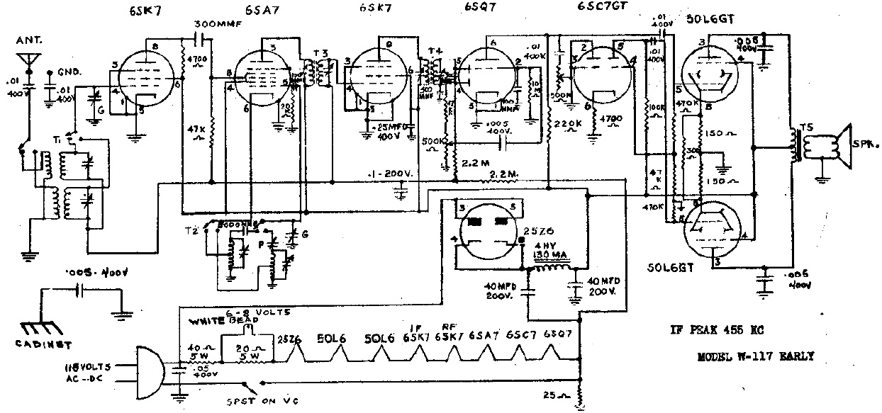

I am posting up a diagram of this "early" Minerva tropic master for our records if thats ok.

on the diagram below,, the tube line downstream of the power plug show the grid power if i am correct.
what pin numbers can i "assume"  are shown.
the print assumes the user is qualified and trained so leaving off the pin numbers  ,,, i dont mind but i want to document them on the print by hand myself.
I am still looking for a very clear version of the diagram but this one will have to work for me.
