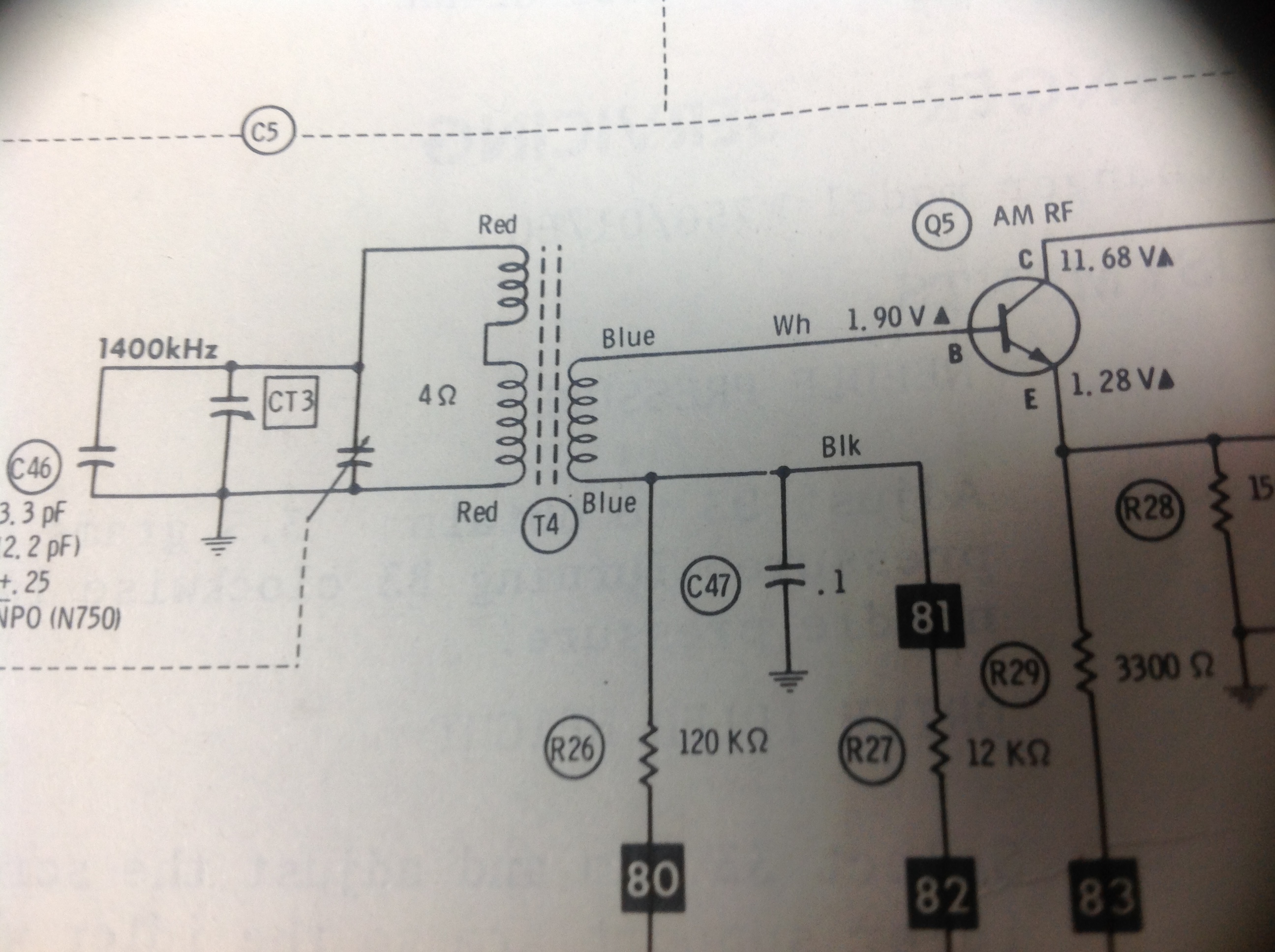

Sans schematic of AM front end. I did also disconnect C46 on the Left of the print and no,difference.
