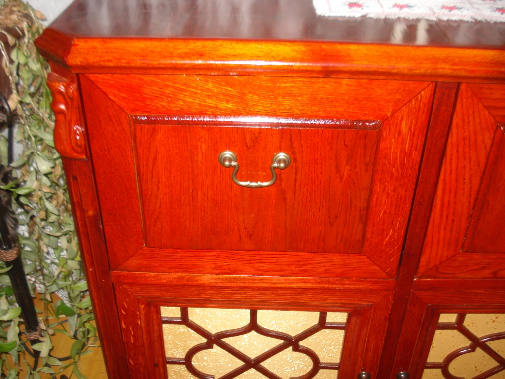

In Ukraine, the level of the epidemic on Kovid 19 is growing again and because of this the quarantine becomes stricter ... So there is more free time for my hobby. The body of Zenith was varnished with 3 layers of nitrocellulose furniture varnish and began the final assembly ...
First of all, I bought decorative antique buttons, very similar to the original handles from Zenith.
The appearance is almost complete ... Icon_rolleyes

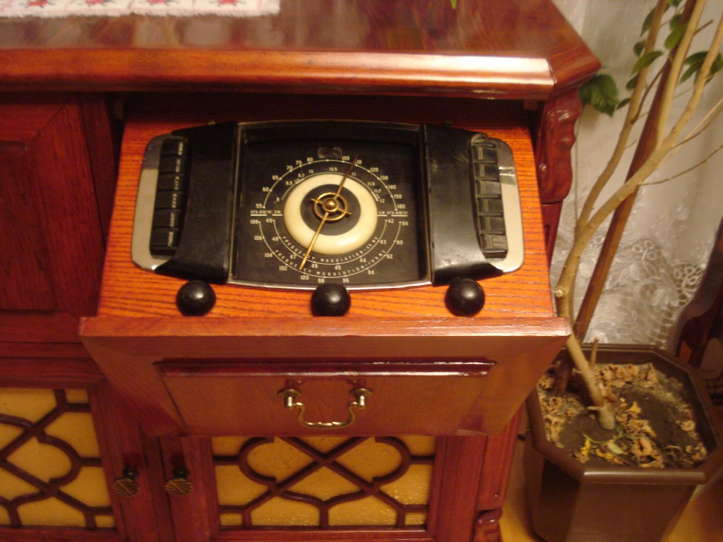

Then installed the tuner and amplifier in place. Then it was time to install an automatic record player ... The big problem was that we could not buy the original player from this model of Zenith and therefore had to experiment with selecting the right functionality and size. And then I remembered that somewhere I had a wonderful English player Garrard RS75 ...
This player did not work and had another problem - there was no metal needle of the cartridge with a corundum end. But I managed to repair the player and temporarily install the piezo cartridge.
