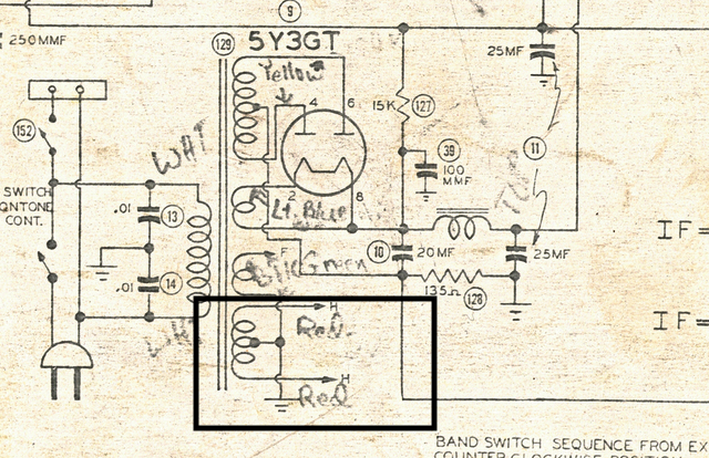

So, the Yellow leads HV, Black leads rectifier (F) , light blue Filliment 1, and red (H) Filiment 2 or audio , Green Center Tap ?
