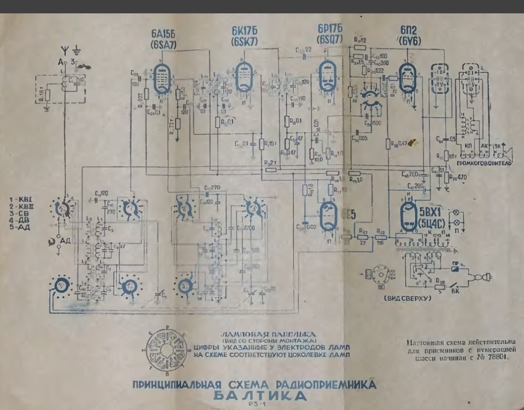

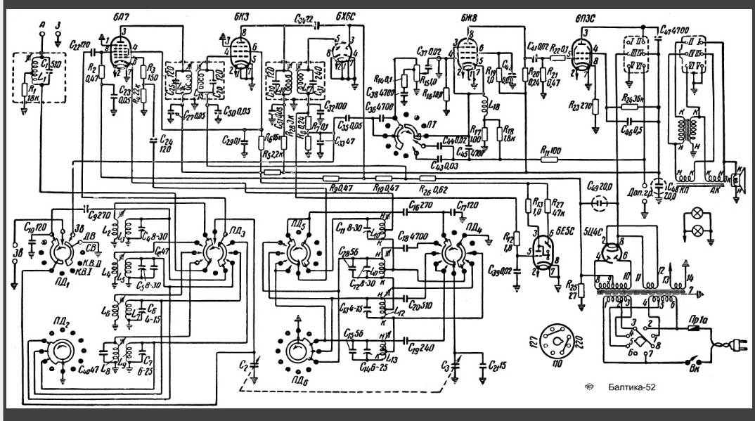

OK . I am sending you all three Baltic models.
Baltic RZ-1 . 1950
Baltic 52.  1952
Baltic 54.
The main difference between the Baltic RZ-1 and the other two models is that it has only 6 radio tube.Models Baltika 52 and Baltika 54 have 7 radio tubes each
And the Baltika 54 differs from the other two by its permanent magnet speaker, instead of the combined magnetizing speaker as in the two earlier models. The most popular and popular was the Baltika 52, the Baltika RZ-1 is a rather rare model, and the Baltika 54 is very rare.
