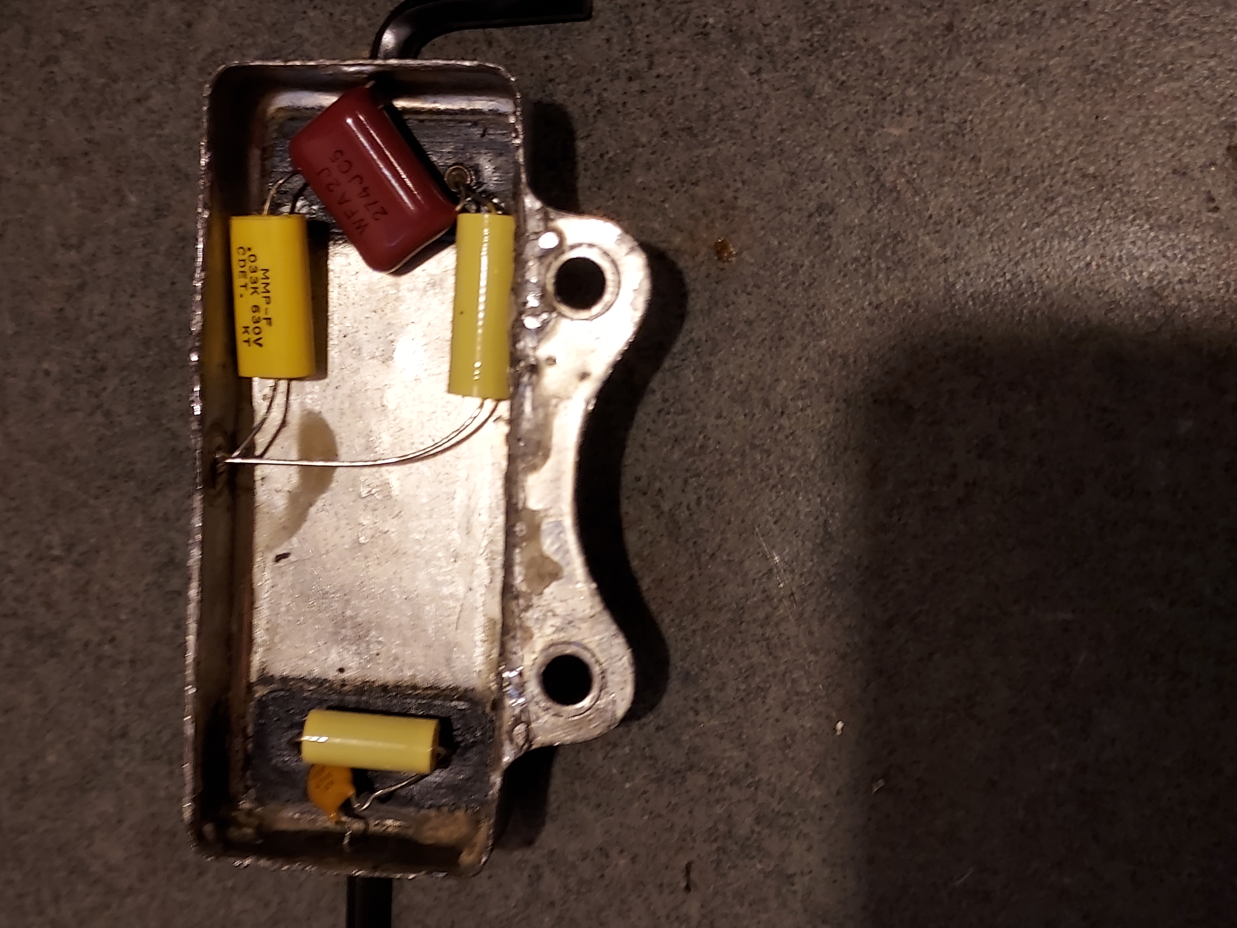

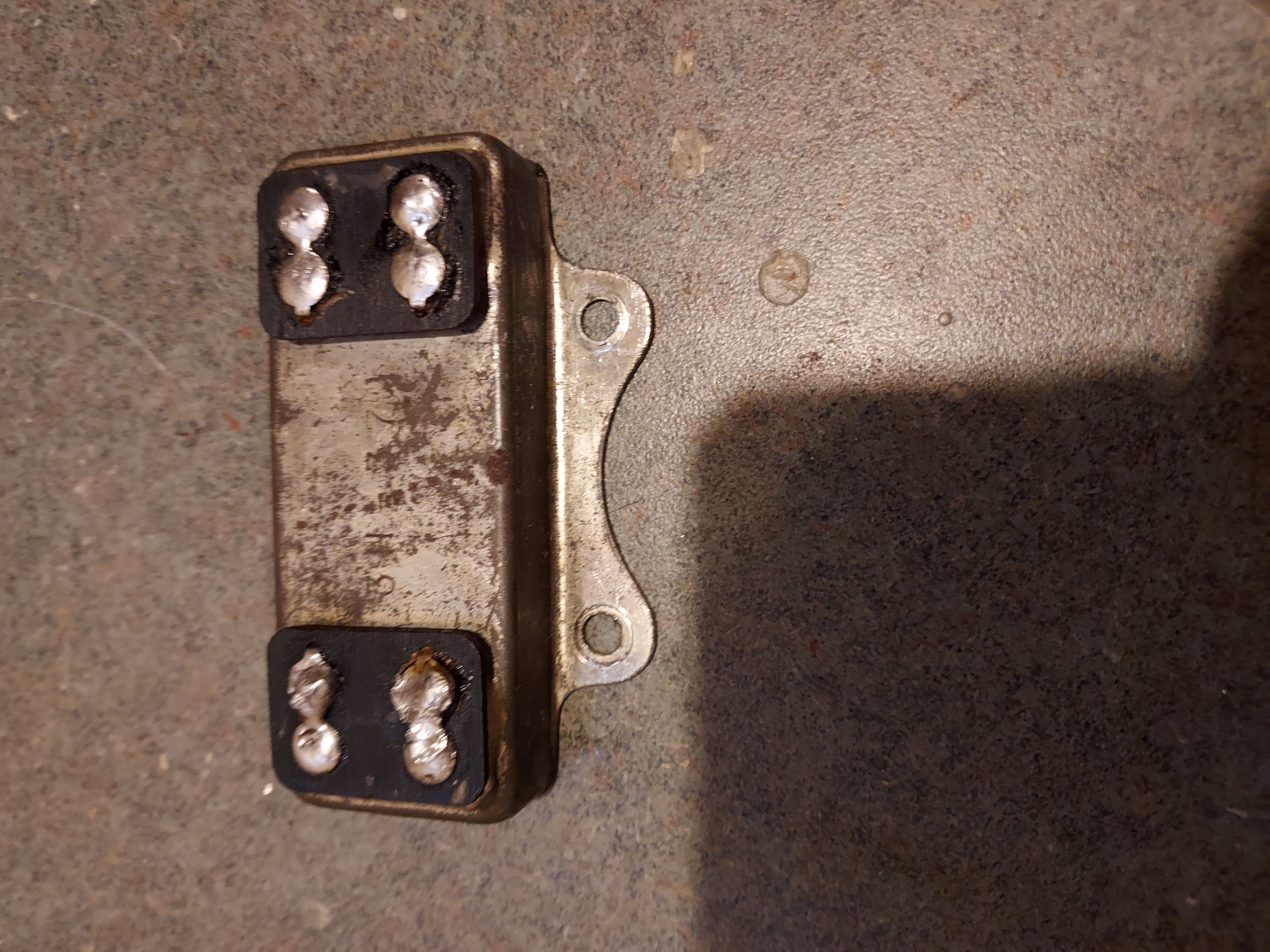

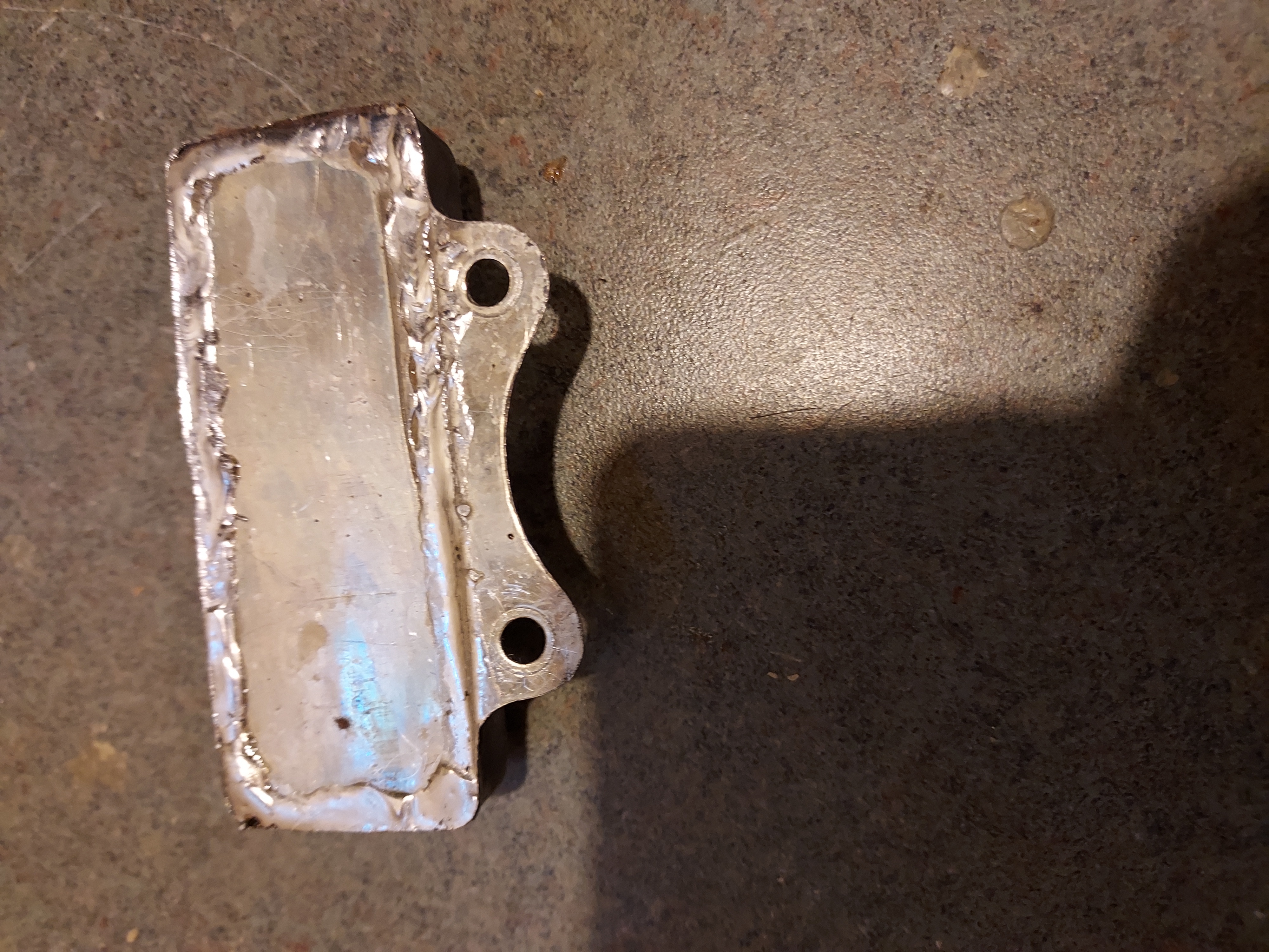

The last cap can re-stuffed.
And closed

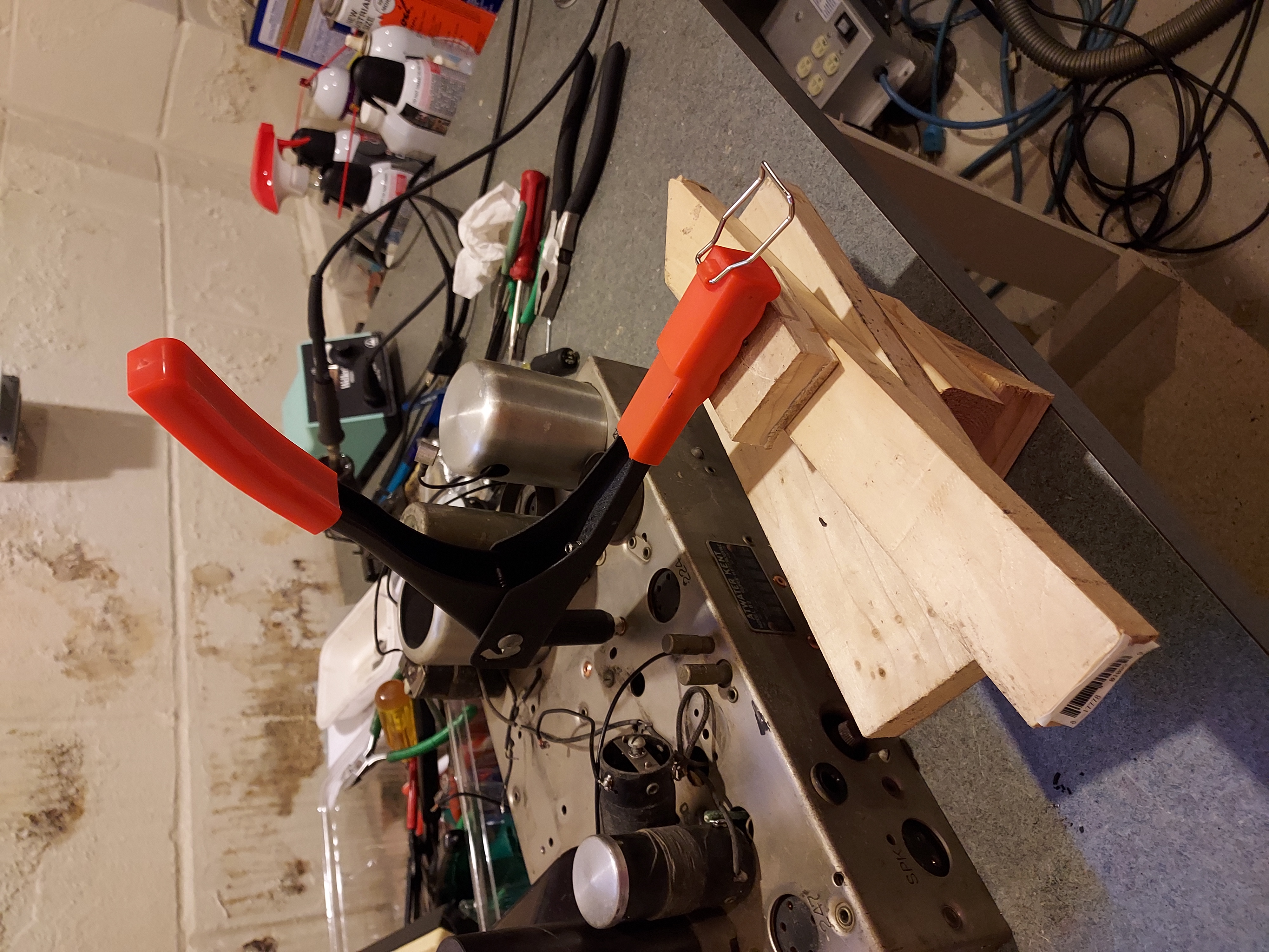

And riveted. These rivets are tough to set with the hand tool I have: with two hands it will flare most of it but will not tighten unless you have very strong palms grip.
So I used some support and my weight as the force.
