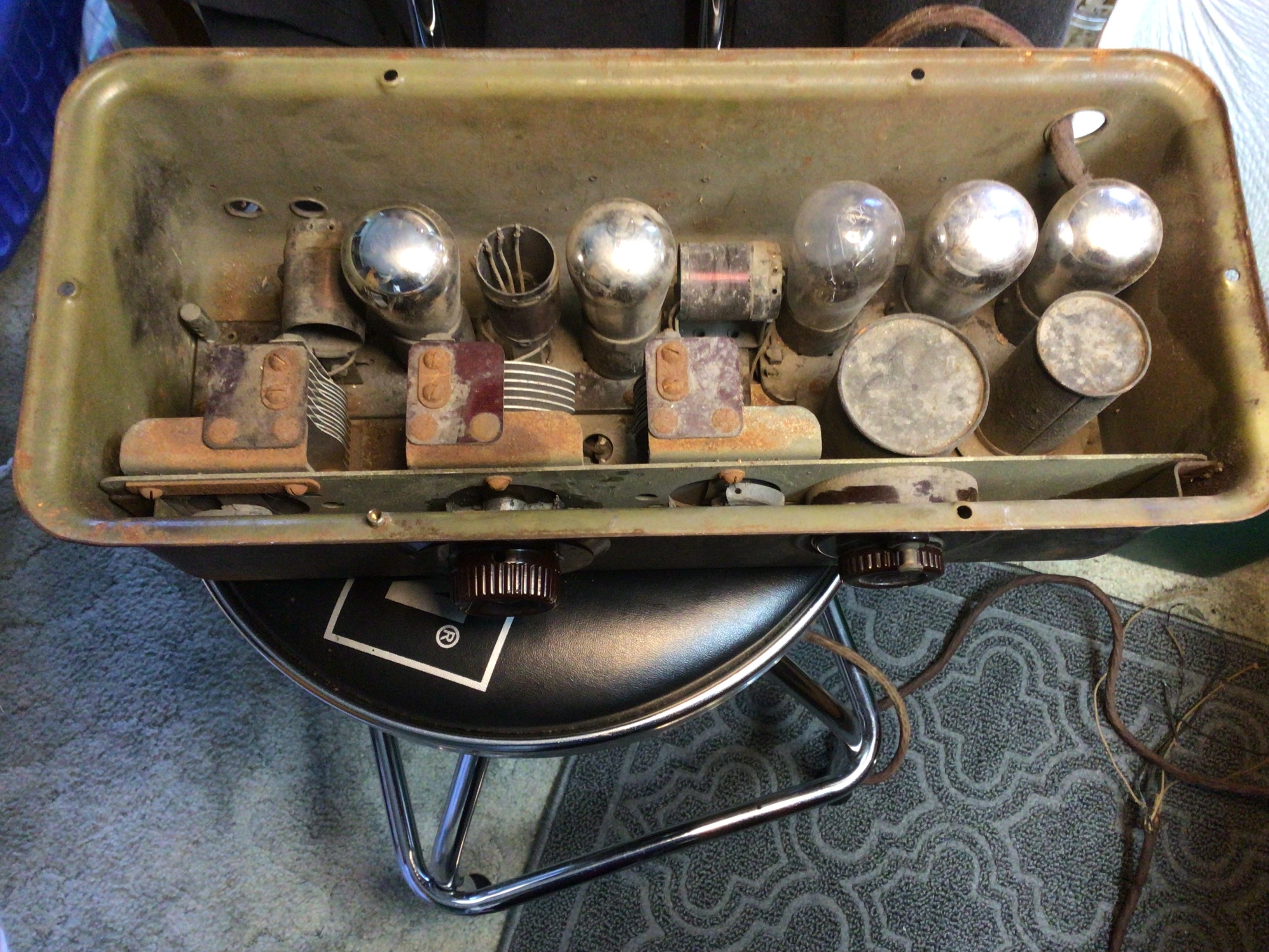

Coils on both chassis look to be the same and in fact they measure within a few micro Henries of each other except for the 3rd stage which is about 20uh more on the parts set. Attached picture shows my set but the parts chassis looks the same!
MrFixr I believe I will do as suggested, I will change just the variable caps and then the coils if need be!
