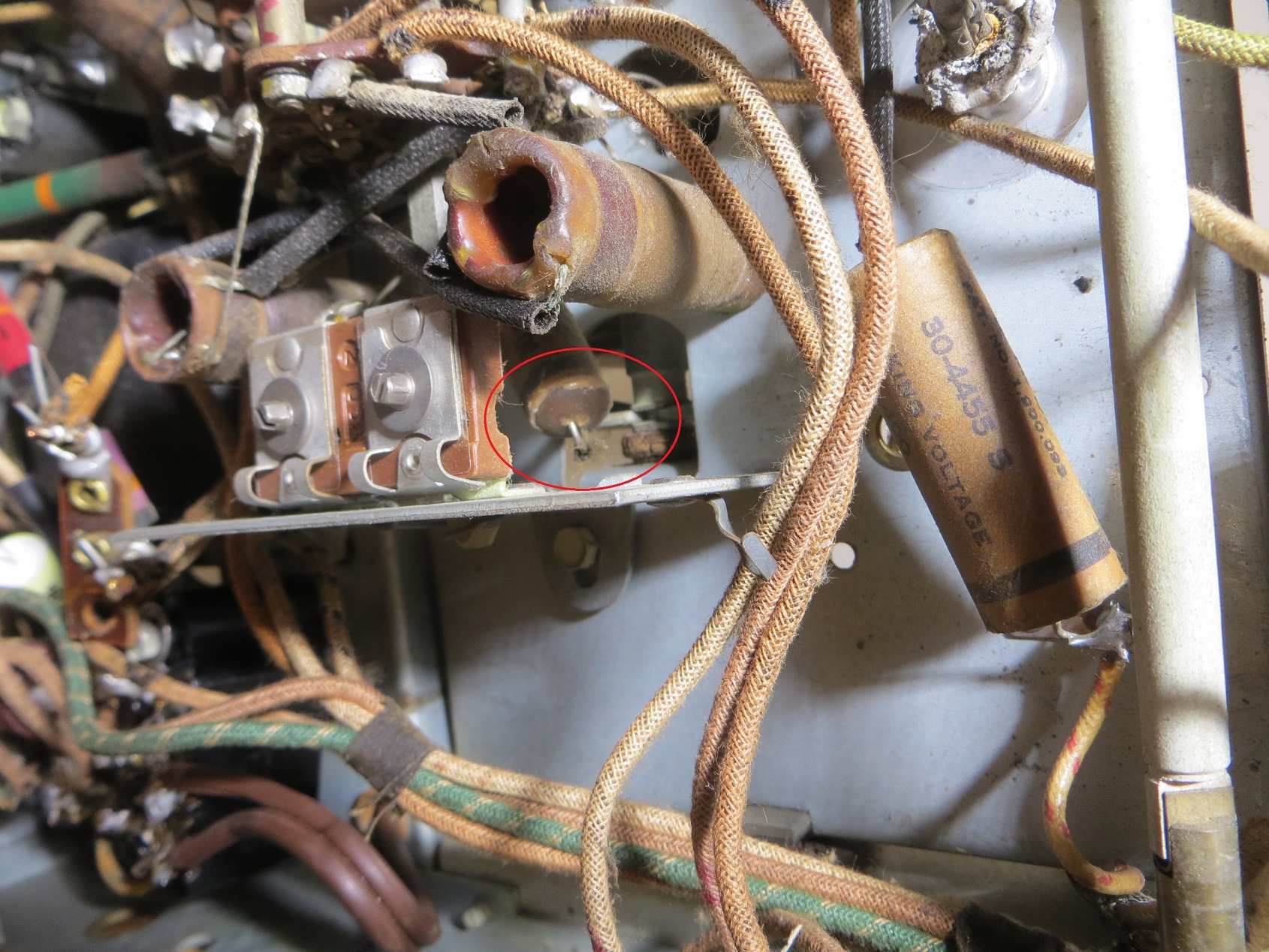

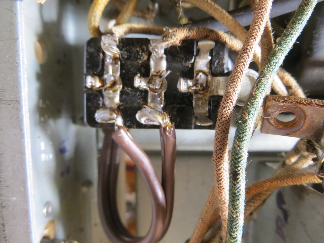

I got around to soldering the power cable on, and the caps in the Bakelite box.

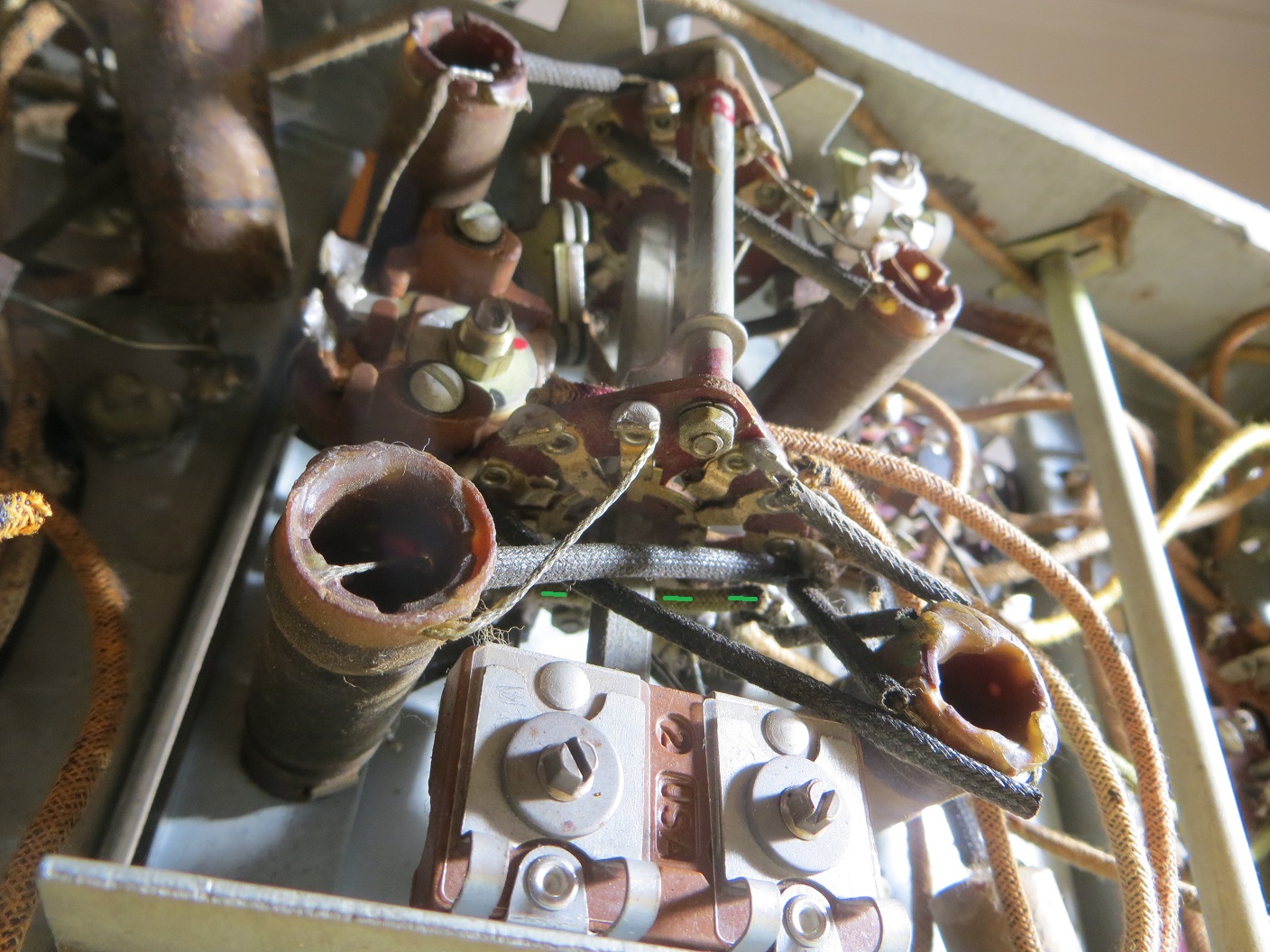

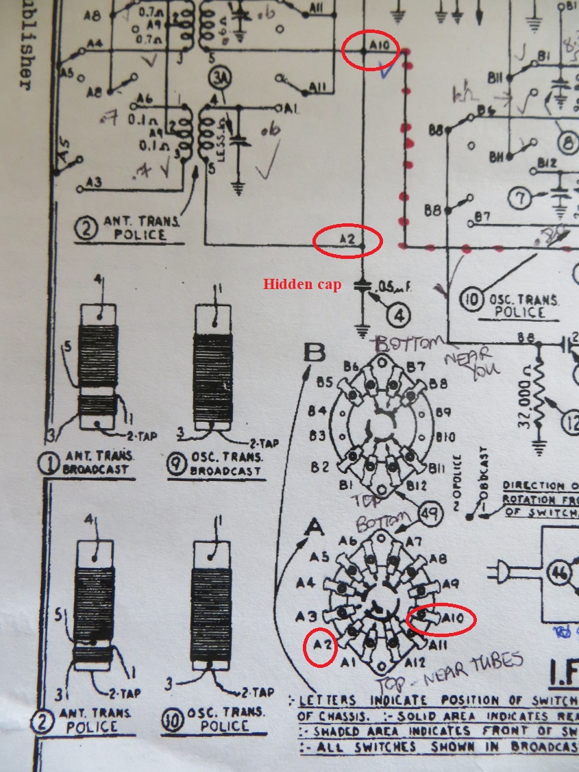

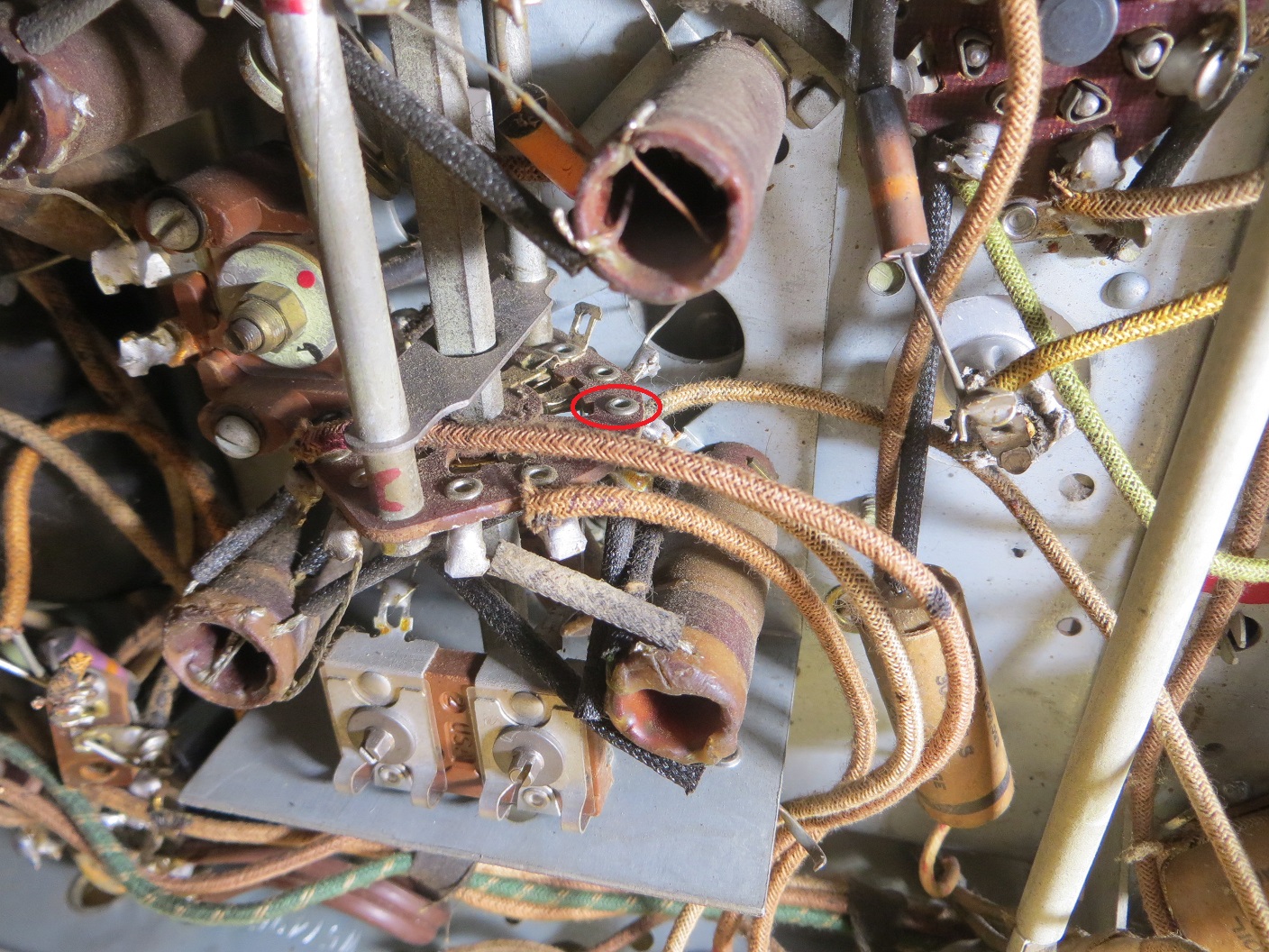

I sat awhile trying to figure out how I was going to replace the part 4 capacitor that's hidden under the wax antenna tubes.  One end you can clip and solder a wire, the other you can't get to where it's attached to the A switch.  Don't want to move the sub-chassis.  Finally figured out there's a green wire under the switch that connects A2 to A10. A10 is much easier to reach. Might be longer, but I'm connecting it to A10.
