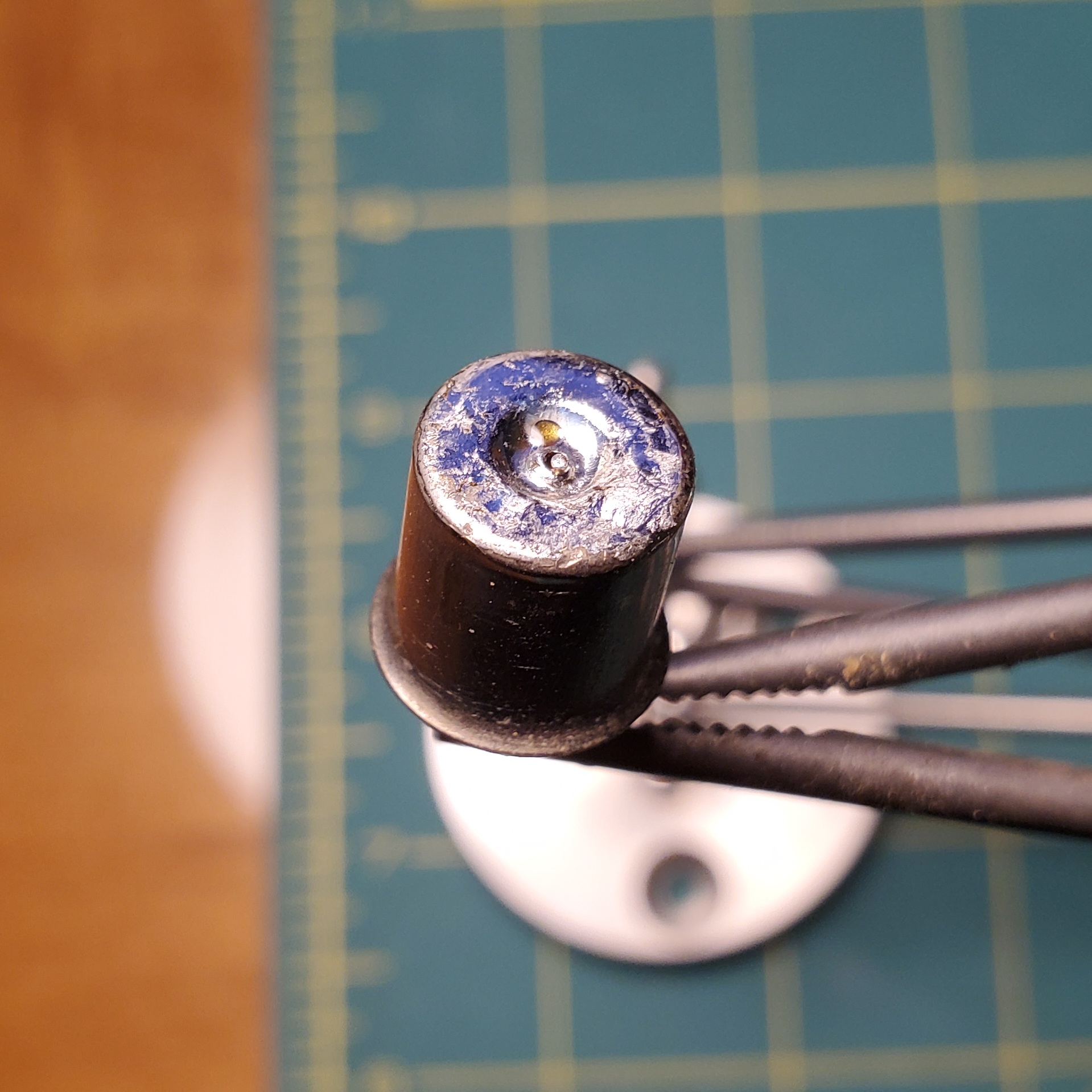

Here's a picture of the tiny lead stub - less than 1 mm - protruding through the top cap hole from the 39/44 tube that fell victim to my repair efforts. Three tubes were like this - even with reflowing the solder, the chances of a "dry" joint seem high if no extension wire is added.
