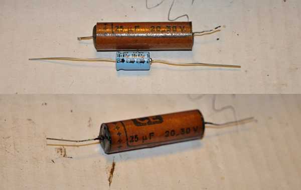

Regarding picture 5 on page 1 of this thread this capacitor is #40 on scematics diagram - 4mF+4mF. Black wire is "-" (grount), red and green "+".
But it look like this capacitor was dead and as parralel was soldered two another, in blu and metal.
My advice - foud two new capacitors 4mF x 400V. It may be very small. And restore old as I present in my message here:
https://philcoradio.com/phorum/showthrea...#pid206311
[Image: https://philcoradio.com/phorum/attachment.php?aid=32368]
