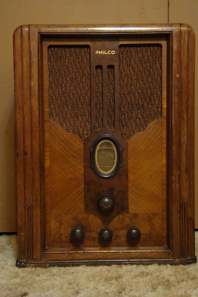

So, here is my newest arrival!
[Image: http://www.philcoradio.com/images/phorum...e00001.jpg]

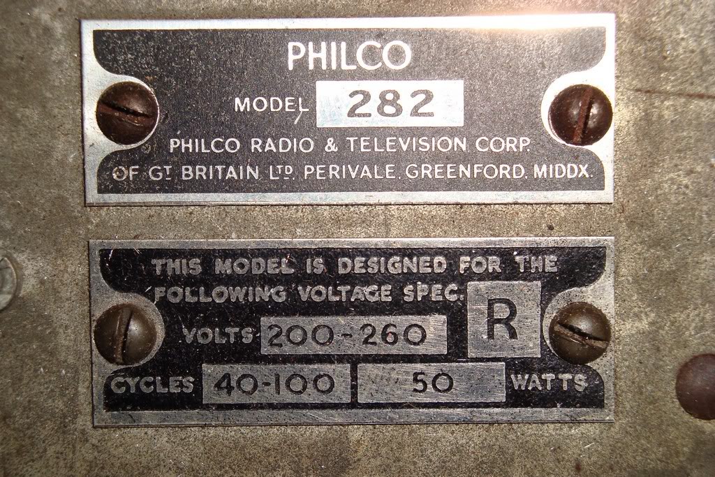

Called the "Empire Five" (five tubes or valves), this model 282 was made in Perivale.

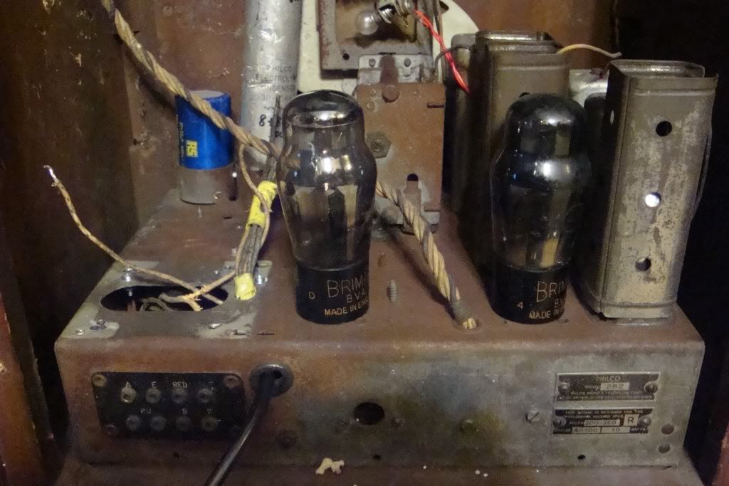

It mostly survived shipment. Unfortunately, it had a non-original power transformer that was barely fastened in, and it came loose and bounced around between England and here. Fortunately, it only damaged the two electrolytic capacitors. It could have been a lot worse. The transformer was dangling by one wire when it arrived. I cut the remaining wire and removed the transformer.
[Image: http://www.philcoradio.com/images/phorum...e00004.jpg]
The transformer could have struck the 80 rectifier, but amazingly, it apparently didn't. At any rate, the 80 isn't broken.

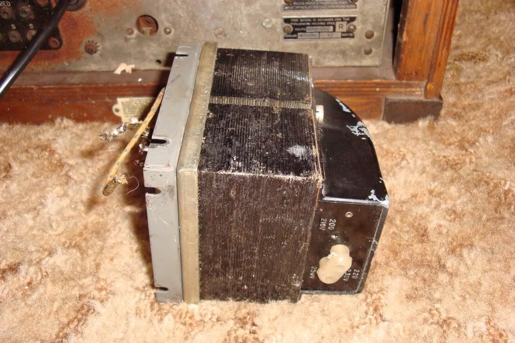

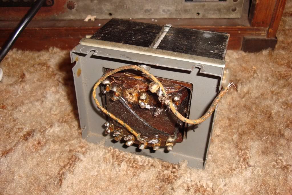

Here are a couple shots of the transformer:
[Image: http://www.philcoradio.com/images/phorum...e00006.jpg]
[Image: http://www.philcoradio.com/images/phorum...e00005.jpg]

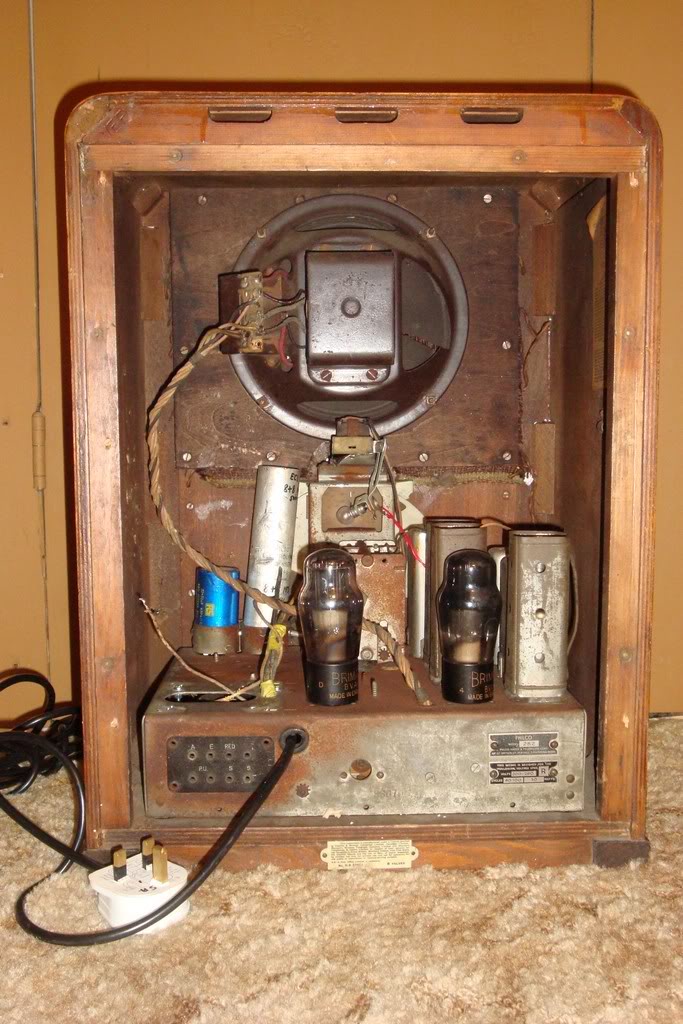

And a closer look at the back of the set:
[Image: http://www.philcoradio.com/images/phorum...e00007.jpg]
Now that it's here - and since the power transformer was not original anyway - I plan to convert it to 120 volt operation so it can be used here, by adding a new vertical mounting power transformer, which is the same as was used originally.
