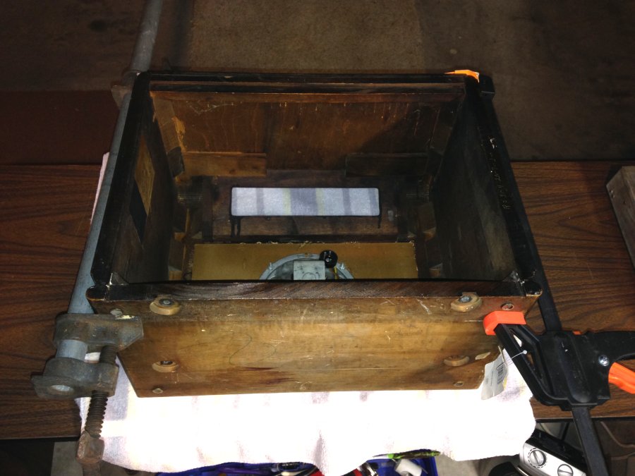

Well, as I wait for the glue to dry in the cabinet...

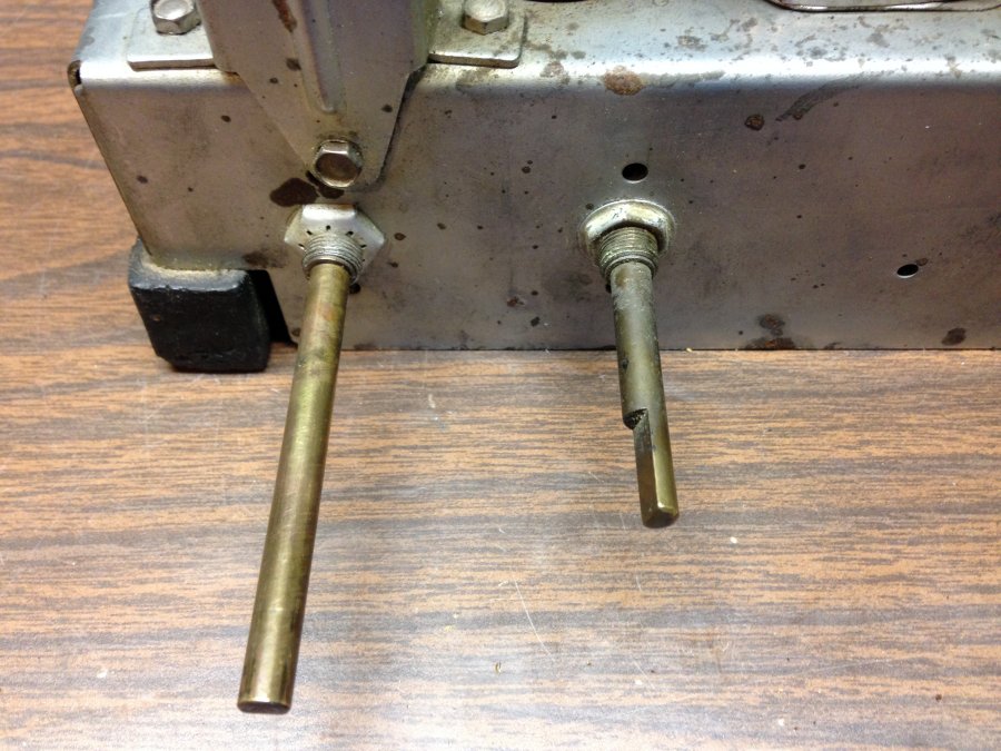

I proceeded to finish work on the volume control shaft.
Here is how it looked at first.

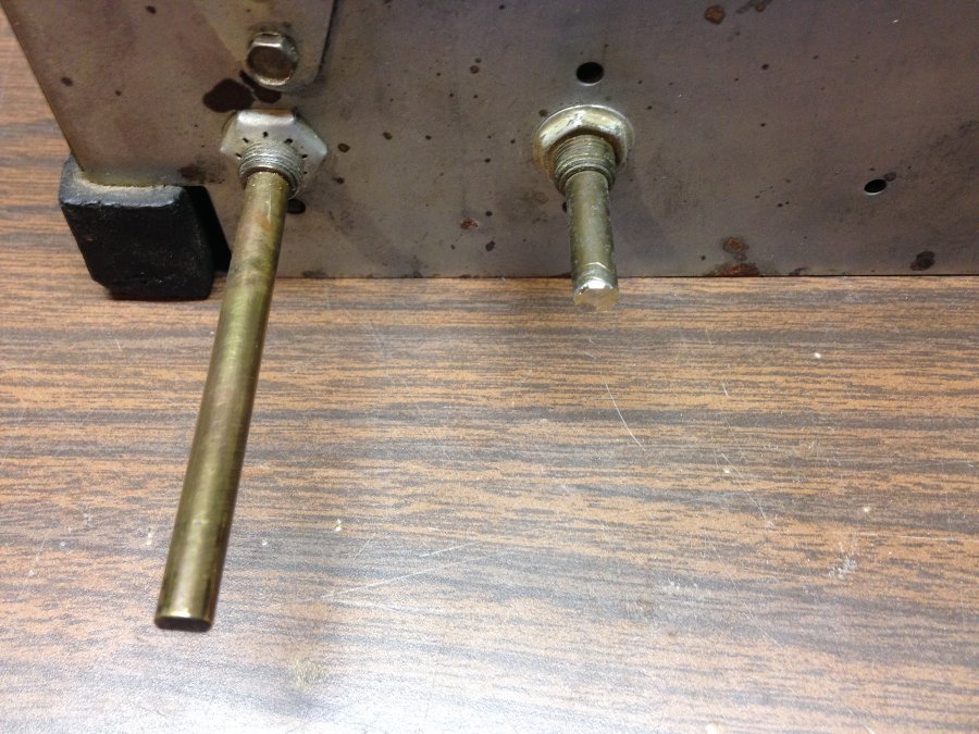

I cut off a portion of the shaft...
[Image: http://www.philcoradio.com/images/phorum...e00030.jpg]

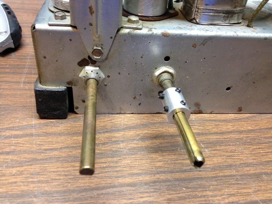

...added a coupler, then added a length of shaft from the (incorrect) volume control that was in the radio when I bought it:
[Image: http://www.philcoradio.com/images/phorum...e00031.jpg]
Once the glue dries in the cabinet, I can reinstall the chassis and I'll have another one finished. Icon_smile
