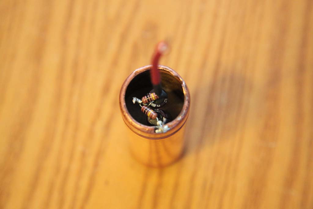

Just so nobody gets scared.....I potted part of the caps so they stay put and the wires do not touch the shell. It is pretty sturdy. I showed it before I potted it.
I used two 10uF 350V caps, and I equalized the leakage with 1M resistors.
When I use 450V caps I do not add resistors but with 350V I do.
