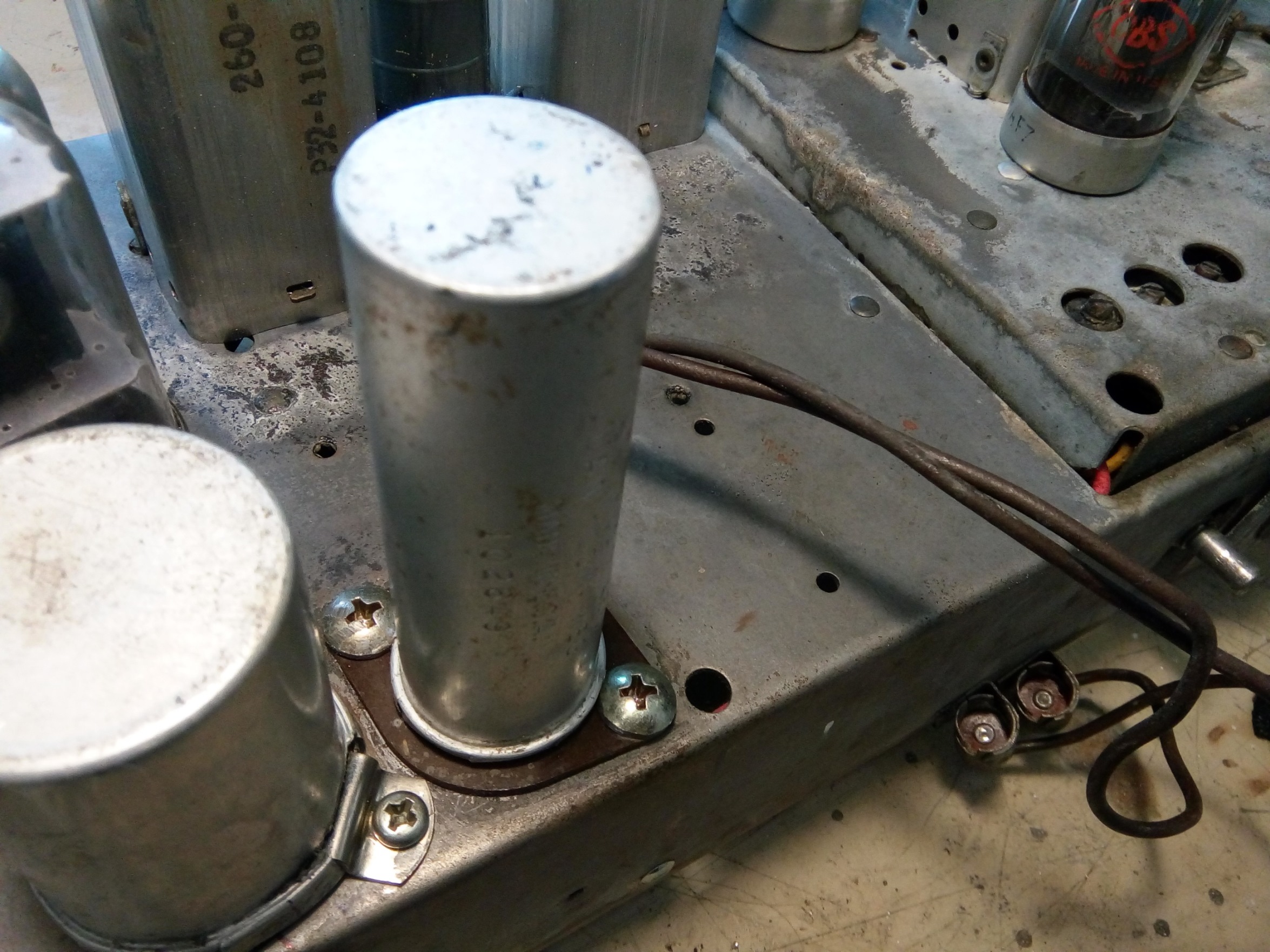

found the problem....  see below picture.
it was all wired correct and to my frustration i powered down to simply start swapping out all the tubes to shot gun it.
i looked down and noticed C101 originally had rivits but i used screws to mount it after i restuffed the cans.
Earlier i kept saying C101 is *NOT ALLOWED* to have a chassis bond directly to chassis?
well i caused it to do just that.
THere is a metal retainer ring in the bottom with lugs that was originaly used to collect the negative sides of the capacitors.   My mounting screws were touching the can,, the screws screwed into the chassis and the heads rubbed / touched the cans thus bypassing all together the Candohm R100.
I changed the screws out for smaller profile heads and adjusted a few things.
another sorta hard problem to find but i got it only after getting the help i needed to focus on the possible defective area.  Thanks!

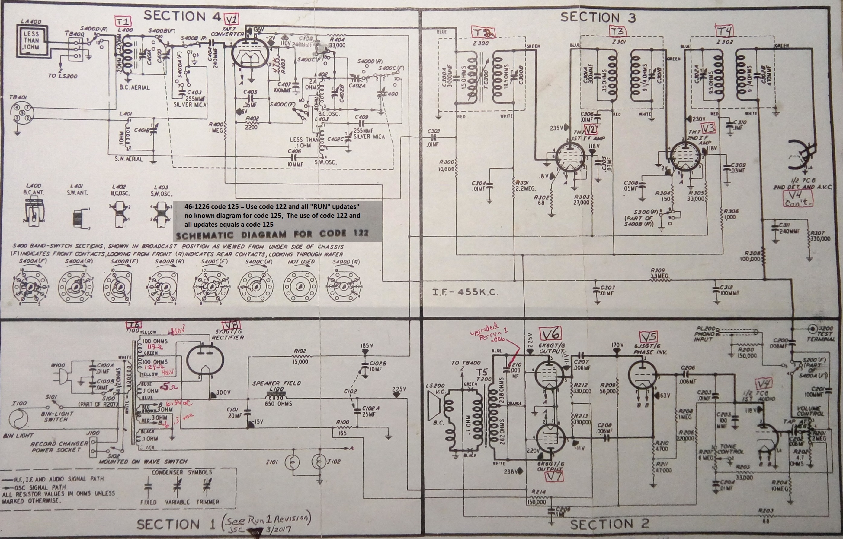

What pin of the 7AF7 has 300 V on it? I don't have the schematic of your radio so I can't follow.
i posted it a few posts  back ,, not sure if it was improper to do so since i had to get it from the philco workbench.
you can not use this diagram as a stand alone for any 46-1226 code 125 because there are a lot of big and small changes,, which i posted in other posts... i bundled all the changes into one picture so you see the progression from code 121, code 122 and code 125.
here it is
like pin 7 is supposed to be the shown value but i have 13.5v
Pin 6 is i think ridiing close to 300v..
some voltage readings are very dead on.
