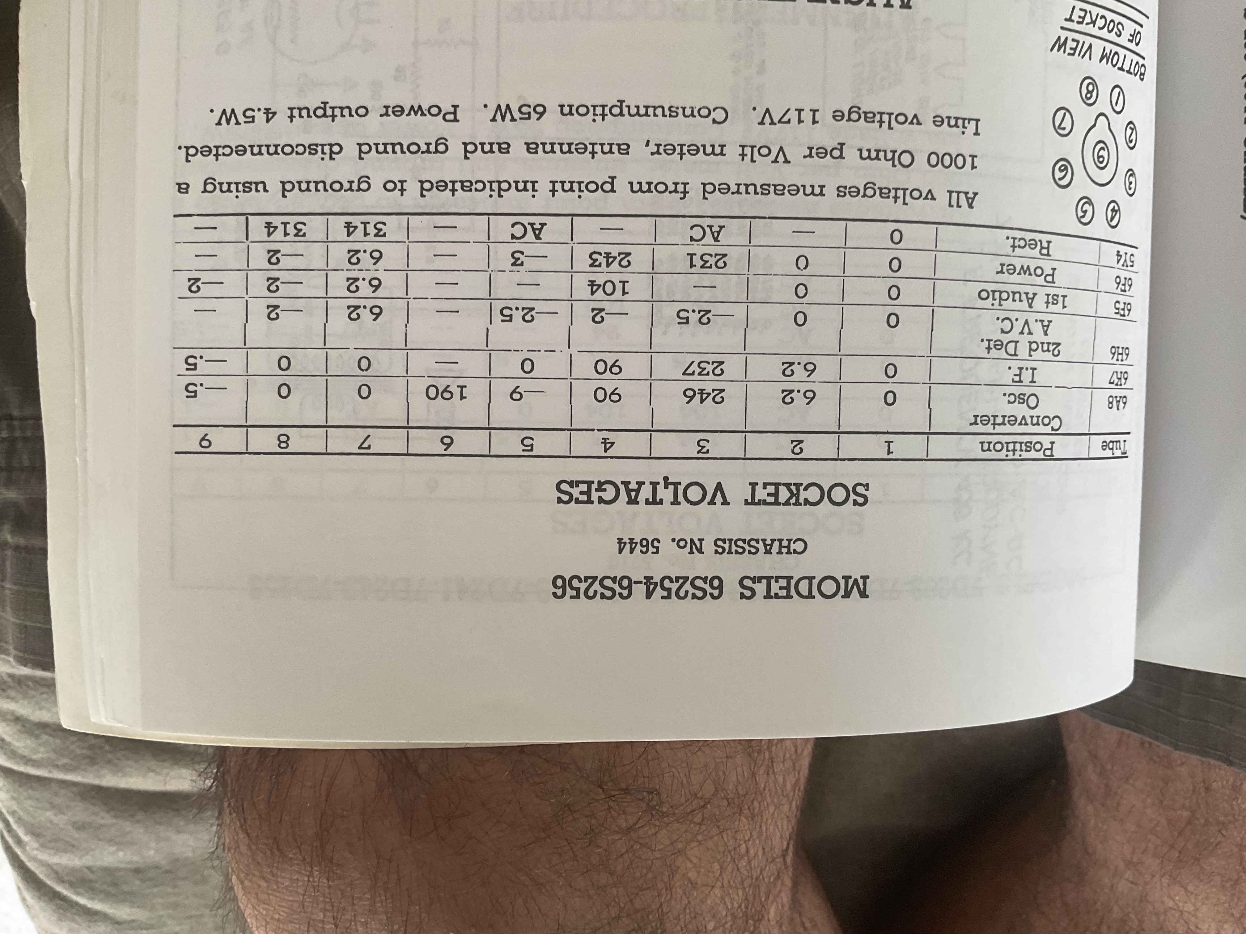

Please see the voltage chart I took from the Zenith Service Manual. It’s easier to read than the Rider schematic. Looks like measurements are from chassis ground. Pin 9 would be the grid cap. Hope it’s useful.
Tony
You should be able to get a rather negative AVC voltage. If you have a similar radio, make similar measurements of cathode current, plate and screen voltages and AVC voltage upon direct signal injection, then compare the AVC voltage under these conditions between the good radio and the radio with issues.
