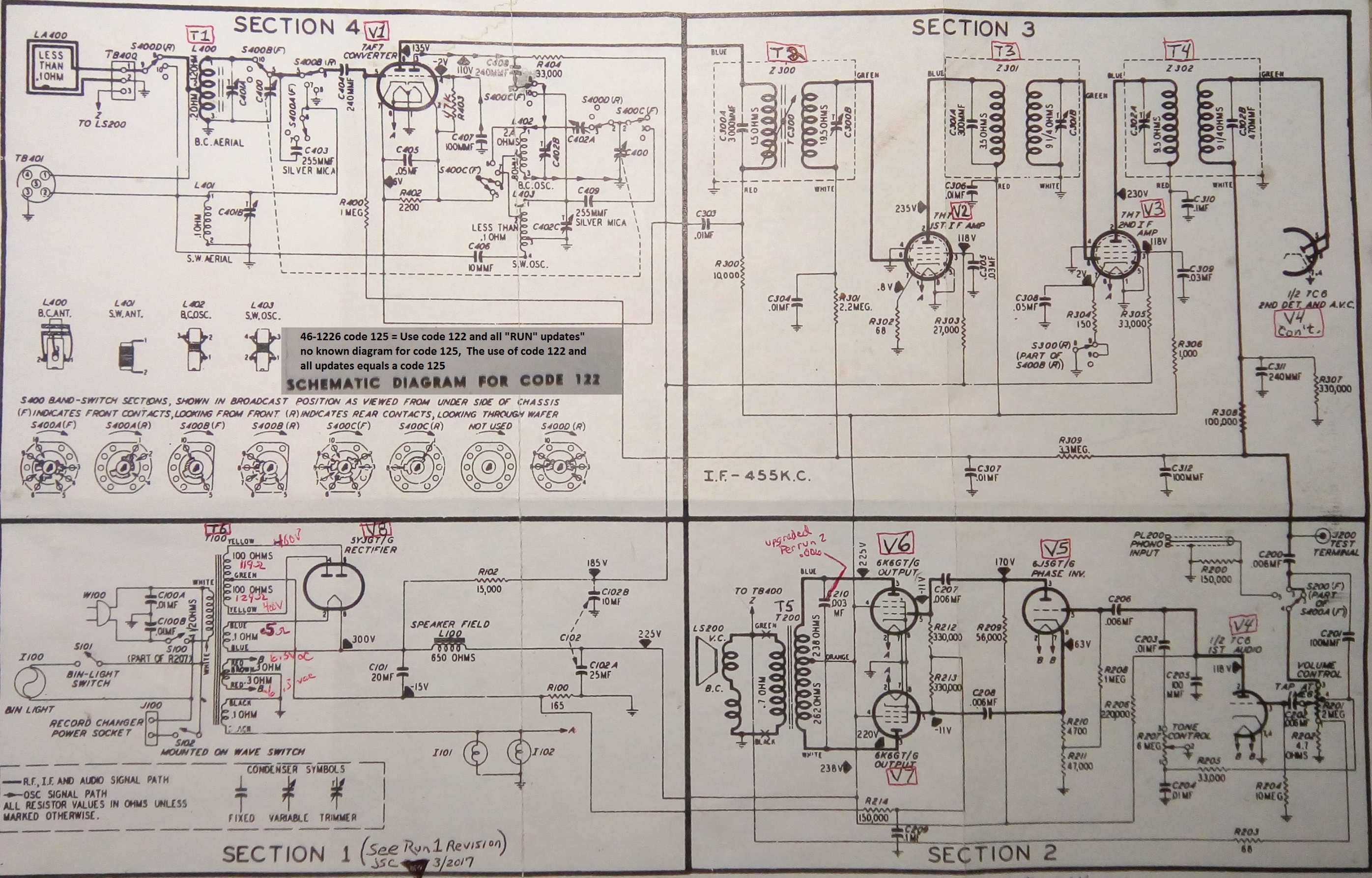

troubleshooting repairman guide says that a hum will occure if the C209 is open,, i had 19vdc on one side and 0v on the other so its certianly not open,,, C209 is grounded on one side.
I do not see the C209 (or anything with this order of referencing) here
http://www.nostalgiaair.org/pagesbymodel...013588.pdf
C35A/B could potentially cause hum.
Also, powering through a cheater plug might tell you if grounding affects it.
see section 2 , very far bottom left.. C209 bonded to chassis
nostalgia air does not have a code 125,, they do have a code 121 available. code 125 is a make up of code 122 and all of its updates.
to be nice,, i updated post 1 with all this information so the reader has the info on the front end.
this diagram coupled with the code 122 run updates and code 125 updates= a code 125.
there is no known schematic dedicated unto a code 125 stand alone

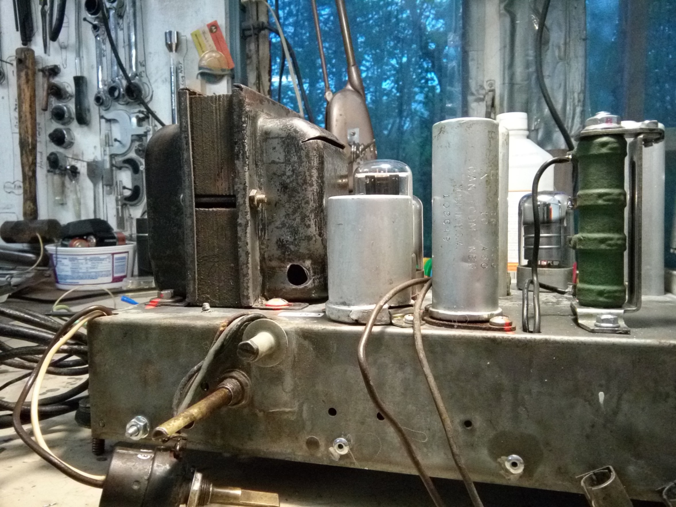

It occured to me that i have an opportunity to let heat out of the transformer easily because one side comes off whithout any wiring conflicts.
i removed the one side cover of the power transformer.
i drilled a hole on each side down low.
the purpose i feel for these two holes is to allow the heat convection to suck air in,, then the opening at the top acts as a chimney.
I hacksawed a slot along the top and sorta bent it out a tad so nothing can drop into the transformer giving it an awning so to speak.
now when there is a heat issue, a lot of it can get out instead of being trapped and such.
now i cant find any spot on the transformer that is over 115 deg f.
the vast majority of the heat introduced on the power transformer is sourced from radiant heat off the rectifier tube and the 6k6's on the other side you cant see.
what i do know is that 300 ohms is wrong for the code 125 update.. 500 ohms is ok,, and 600 or so is working for me. just my 2c worth but its been a good trial and error on the part of an amature here who knows little about these sets , but thanks to the help here, im getting more comfortable.

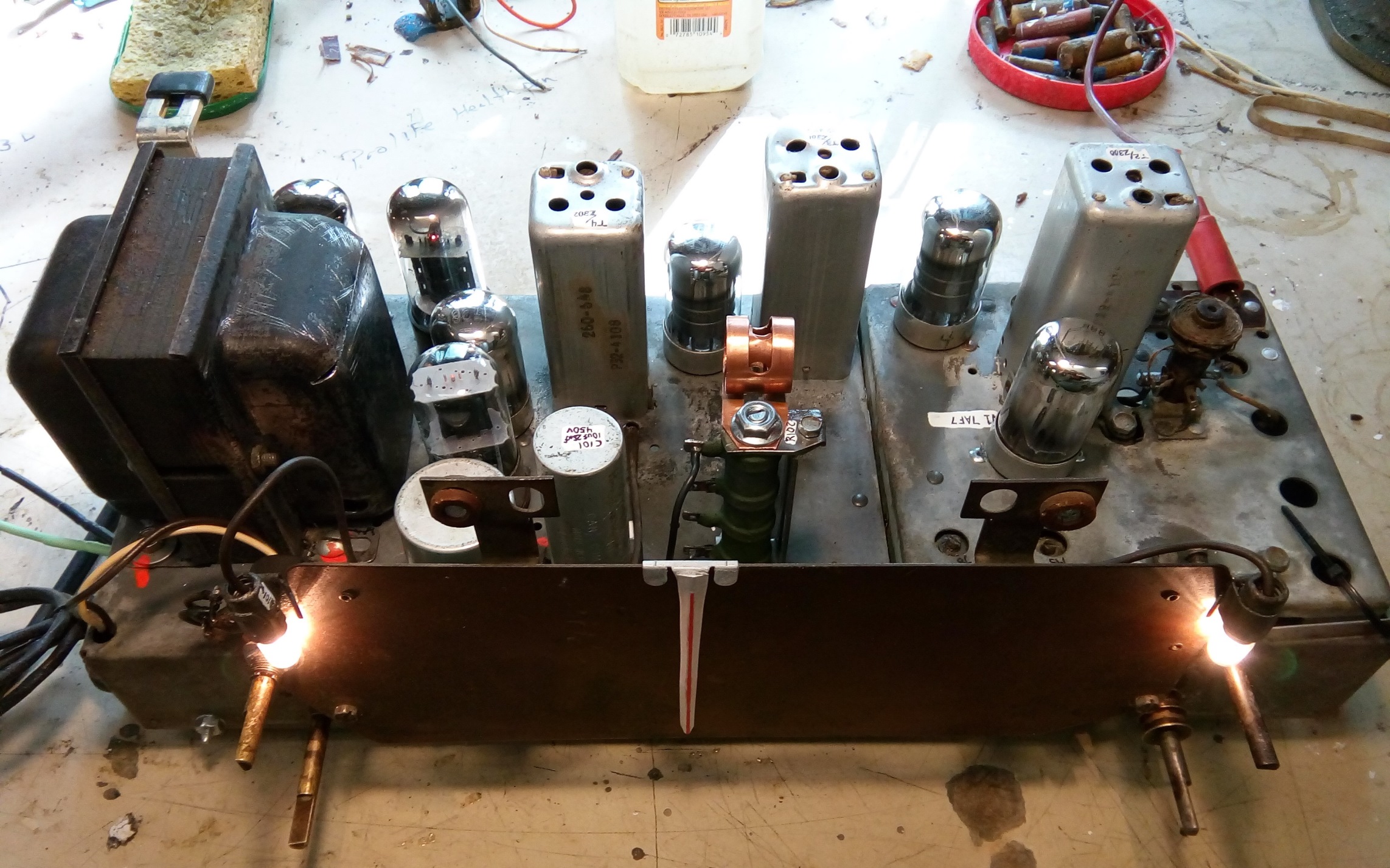

since i have a pointer thats broken up at the slider part, RadiolaGuy said to just fab up a pointer and attach it to my slider then paint it up and be done.
seems like a reasonable fix to me. I should be able to do this with little delay.
putting the radio back together and in the chassis will be my last step, should have the needle built tomorrow.
glass wont be in my hands for 2 weeks, since they are custom made to order for around 25$ or so.
my first go at making a pointer needle.  Had to make it two parts if i wanted it fast and i was surprised this only took an hour to fab up,, not counting paint. had to stare and compare at various images and such to get the shape fairly close. I think i have my colors wrong though,, i think OEM was white on red,, not red on white.
also i was able to shave off an addtional 20degF off of R102 by adding that pigtail copper roll heat sync you see there that stands out like a green fly in a sugar bowl.
so far so good.  just waiting on the dial glass and im all set,, umm,, well until idecide to work on the turn table part.

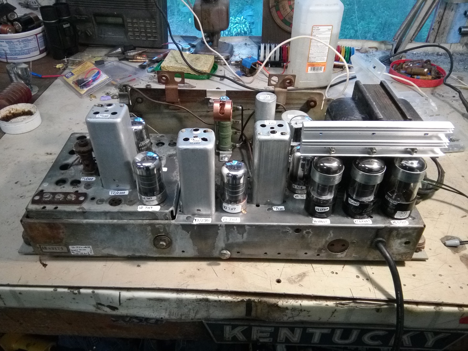

I did some reading and found an old patent on heat sync slip on metal corrigated tubes that slip over a hot tube to help wick heat.  That gave me the go ahead to rig something up on my own.
I studied where the vast majority of heat production was and found that its the hottest right at about 90% up the tube.  of course this makes sense so i designed a heat sync for my rectifier and dual 6k6's.
I used metal strap material and made it into a hook which comes around and bolts to the aluminum plate.  think candy cane hook.  It friction slips on and can expand and contract without worry of breaking the glass.
another thing is that when installed, the chassis sits at a 45deg angle,, well close enough for the sake of conversation,, and the orientation of the recitifier tubes and the two 6k6's , these tubes just radiated a ton of heat upon the transformer. prior to this mod with the radio on the work bench simulating the angle, i recorded 138degF on the transformer. Now i am hard pressed under the same simulation to find over 100 degrees.
i was able to shave off about 40deg on each tube doing this.
funny, now that one 6k6 that had a lot of blue dancing around ,, well you can barely notice any blue at all.
i have since added another hunk of aluminum to gather even more heat but this has to be enough.

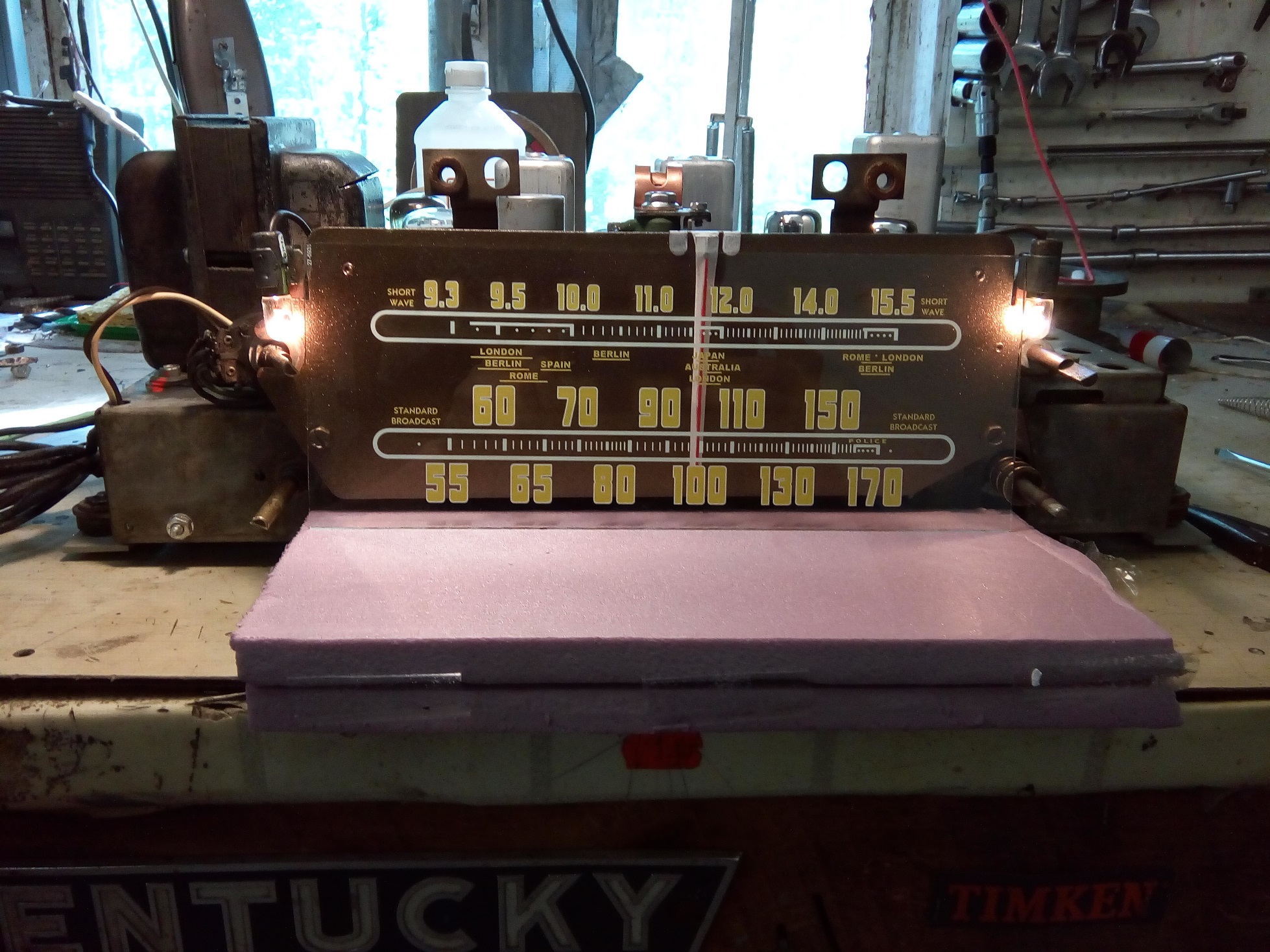

got my glass today from Radiodaze.... awsome!
for some reason i believe i recall the back of the glass being a gold ish color meaning that you only saw the pointer needle trhrough the oval like dial slots, i dont recall being able to see the whole needle on the old glass.
this is good enough ,, and its worth the purchase
back in service,, now to figure out a random outside antenna wire now that its in the house.
