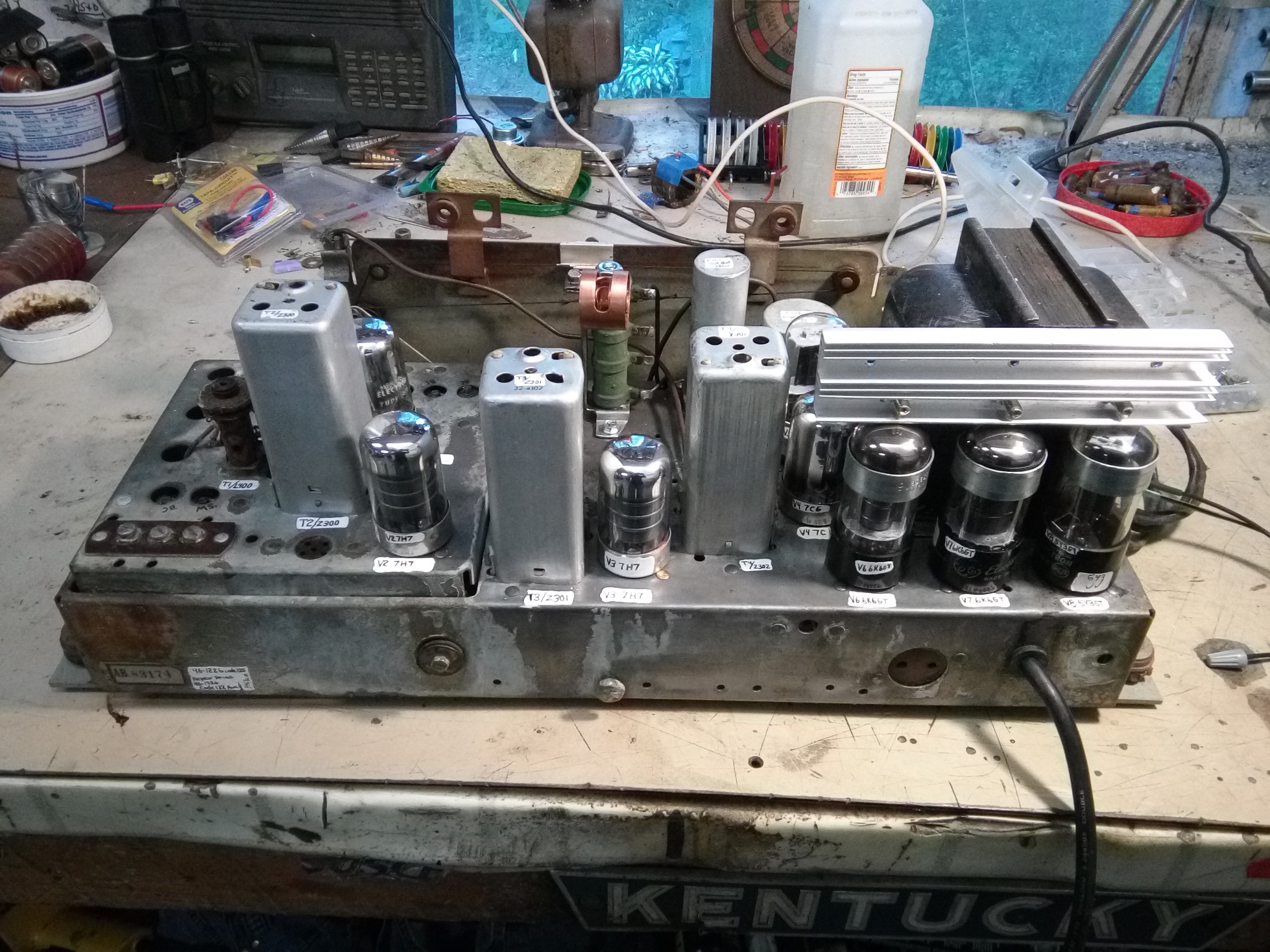

Also, please elaborate on your heat sink on the output and rectifier tubes. That is interesting. That might be something useful for a nice tube stereo receiver, where the output tubes run HOT HOT HOT.

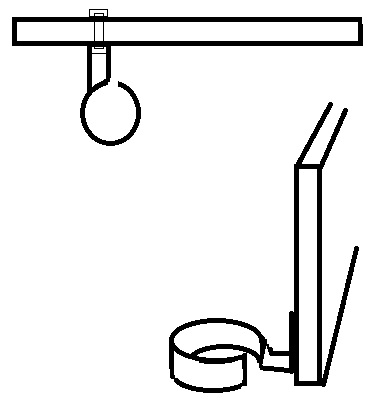

(05-21-2017, 07:07 AM)Ron Ramirez Wrote:   please elaborate on your heat sink on the output and rectifier tubes. That is interesting. That might be something useful for a nice tube stereo receiver, where the output tubes run HOT HOT HOT.
here is whats going on with the heat sync i made up.  and the photo i posted on the previous page of this thread.
I accounted for expansion and contraction of the metal to glass contact.
I'm thinking glass is  harder than steel so therefore the steel will always be "ahead" of the glass at the molecular level ,, as in i tried to account for this setup to not break the tube glass.  Time will tell.
what i really want to do is bond the top of the aluminum plate to the "TOP side" of the power transformer this way heat walks to a large chassis part but........ at this time, the power transformer is staying so cool and the simple air cooled setup vented aluminum chunk i have is keeping temps low enough. ,,, much lower than before. nothing is hitting 300 degrees anymore so from my redneck view, sounds like progress to me.
i wonder if it would be better if the bands were copper instead of steel. ? thoughts on this transition from heat produced and traded off to a metal object that then has another metal object that sucks it away and out into the air??????????

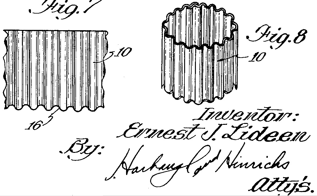

here is the patent i mentioned earlier that gave me the go light to proceed.
i like his idea better than mine ,, corrigated metal slip on cage around the tube,,, yet the dislike i have is that it depends on the tube base for heat wicking.. ... yet.... his design  mentions a convetion being created by way of the design.
From my desk,, it seems his design could "trap" heat in even during the time which convection is being generated.
I coud easily make plenty of these designs in about 5 minutes.
http://www.google.com/patents/US2745895
here is the buisness end of his patent,, flat metal shaped to a corrigation vertically to which then the efforts to bend it around in a circle naturally promote interlocking of the two ends.
the areas curved away from the tube it surrounds would act as a chimney and as heat is produced, naturally it goes up, yet the base would suck cool air in.
I really like it actually, but a part of me says it has to in some fashion actually "trap" heat as well.
in my design i am trying to attach metal to the hottest glass area of heat prodution then pull it up and away. mine is more complicated than his as far as work efforts are concerned to deal with heat,, his is more cost affective and probably does work.... i did not mock up or try his method.
