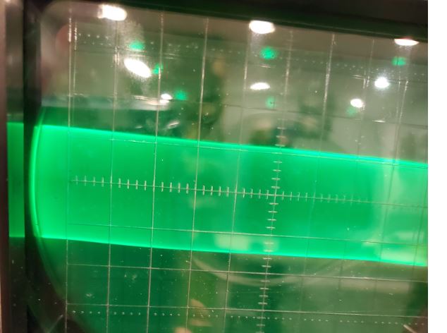

Turned on radio and it was poor reception. Connected scope and got a little over one and a half. Forgot to take picture. Did the disconnect antenna ground and reconnect now good reception. Scope shows almost two. Not sure what you call them. Picture show in good reception with almost two. Notice I could not not get individual pulses at any time. So does this say oscillator is weakening?

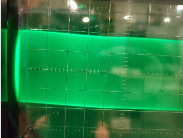

Here is the picture for poor reception.
