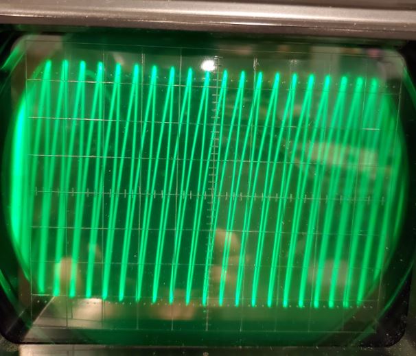

Got it to sync. Here it is when reception good. Waiting for crap out. There is nothing I can measure from. Horizontal range is on third position and sweep speed all the way high.
The shape is a bit weird but maybe it's the scope.
Can you spread it a bit horz, or is this at the sweep's limit?

Sorry best it gets. Radio still playing normal.

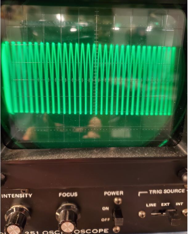

While I am waiting for my new scope I decided to take the osc coil out have a look at it. No Philco corrosion in there but I did find a connection that looked bad so I cleaned it and resoldered the connection as well as the rest of them. Put the coil back and the radio came up with good reception and maybe a little better. I noticed on the scope the waveform filled the whole screen instead of previous half screen. That was real encouraging. Played all day yesterday and came right on this morning and still playing well. So maybe it is fixed (knock wood).
That would be great. That oscillator clearly behaved erratically.

Well, I'm glad you found something concrete that's made a difference. Let's keep our hopes up. Stronger oscillator signal is always encouraging.
Would also be nice to see the oscillation waveform. On this same scope.
Could you snap a shot and put it here?

I played the radio about eight hours yesterday without any problems. I will play pretty much all day today and if no problems I'm going to call it fixed. Here is the scope picture with the stronger osc signal. I will let you guys know tomorrow how it went today.
Over 60% rise in amplitude. Nice.
When you get your new scope, please also put the waveform here; I am just interested in whether it is the way this scope shows it or it is distorted by the scope.
