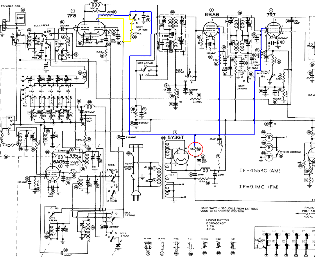

Ok, it's time for me to get back to this. First I need to apologize for jumping back and forth between the Philco schematic and the Sams schematic. In general I prefer working with the Philco schematic because I find it easier to follow. But the copy I have of the Sams schematic is clearer and easier to read. From here on I'll try to use just the Sams schematic when posting here.
I haven't done anything on the 47-1230 for the last 2 weeks or so, but I have done some research, studying, and thinking. I've watched a few videos and done some reading on tube theory and feel like I have a better understanding, but that hasn't helped me determine if I have a problem with too much current being drawn through the 15k, 2W resistor (R127). My current thinking is that the circuit is working as designed. Part of my reasoning is logic (albeit somewhat flawed logic), and part of it is wishful thinking. The wishful thinking is because I really want to call this radio done and surprise my Mom with it.
Here is my logic. As designed, R127 dissipates about 0.96W in AM mode, which is already higher than I would think they'd want to run a 2W resistor. But this is based on the voltages listed on the Philco schematic...310v on one side and 190v on the other, so 120v across the resistor. Simple math tells us that it's dissipating 0.96W. So now, if we assume that more current will be drawn through R127 in FM mode, then we will be running this resistor even hotter. Now here is where the 'flawed' logic may come in. My assumption is based entirely on the fact that my radio DOES draw more current through R127 in FM mode. I'm not smart enough to be able to tell from the schematic if it should draw more current in FM mode. Here is a schematic with the circuit in question highlighted in blue. The yellow section is switched into the circuit in FM mode. Basically, it connects a 4.7k resistor across the 27k resistor connected to the plate of the oscillator section of the 7F8, resulting in 4.004k.
I didn't find this current draw through R127 as a result of some in depth troubleshooting. Basically I just stumbled onto it. I noticed the voltage drop across it and did some math. I tried touching it the last time I worked on it after running in FM for a while and I couldn't hold my finger on it for more than a second.
Unless someone can convince me that there really is a problem here, I plan to replace the 15k, 2W resistor with a 15k, 5W resistor and button it up. But, if you are going to tell me there is a problem, please give me some guidance for determining what is causing the problem and how to fix it. What would you do?

try something new...............
condition- unplugged and the loctal tube removed.
check to see if there is **ANY** resistance from any pin at the top side to chassis. If your in the same boat i was in,, my loctal was suffering from a minor carbon trace. or carbon strike,, whatever its called. i had no socket replacement so i proceeded against the advice i was given and pulled the socket out. i took it apart to reveal the two wafers . I laid the wafer with the obvious gully of a carbon strike down on different sand papers until i sanded way past the carbon trace. i put it back together and that solved that problem.
although its not typical ,,, i actually desoldered all terminations to this socket so i was sure my meter would read just the pins to chassis.
Check to see if the theory on my set holds true to yours.... see if you have an AC and DC voltage drop across that resistor. I could not actually detect it on the meter but,, it should be there invisible to your meter or not. A oscope would surely see it. Because of where it is actually living in the circuit, the thought on my set for this same problem resistor was that it not only has dc but also some ac on it,,,
I was able to gain control of how i calibrated it by observing my voltage at my 6k6 to get it below 300v or close to what the schematic says.

Thanks again jcassity - I REALLY hope your suggestion (possible carbon trace) is not true, especially for the 7F8 (mixer/oscillator) or 6BA6 (1st IF amp). They are both buried under the function switch on the tuner sub-chassis and would be impossible to service without removing it, especially the 7F8. I did do tube resistance measurements in the past and the only unusual readings I got were on the plates of the tubes that are fed by the B+ line(s). In each case the expected reading is in the 180k - 300k range and I read infinity (with a digital meter). I would think that I would read much less rather than much more if there were a carbon trace problem.
I'm sure I do have an AC component across R127, but if I remember right it's only about 200mV. At this point I feel like I may be chasing my tail and I don't want to do that. I did install the 5W resistor, but I'm going to go a step further. I ordered a chassis mount resistor and will install that. There may still be a problem in the circuit, I don't know. But at least R127 will not be a failure point, and the heat it generates will not cause a failure. So if there is no problem in the circuit it will be extra protection.

The chassis mount 15k resistor should arrive today. Once I have that installed I plan to do the entire alignment procedure (yet again!) and then I'm prepared to put everything into the cabinet and call this project complete. AM works well. FM works well. Phonograph works well. The only performance problem I've seen is that there are a couple of FM stations at the low end of the band that I also pick up at the high end of the band. I don't know what to do about that so I'm prepared to live with it. Otherwise, it works really well.

Yes jcassity, that was in reply to your 'current status check'. Other than the current draw through R127 in FM, and the low end FM stations showing up at the high end, I am happy with the way it works.
I have taken voltage readings at each tube pin and compared to those listed in Sams, but those readings are in AM mode. I have taken all the same readings in FM but don't know if they are valid or not, since I don't have reference voltages for FM. The Philco schematic does show voltages at various points in the circuit for both AM and FM, but not for each tube pin.

Today was a big day for the 47-1230. First a quick update. I installed the 15k chassis mount resistor on the top side of the chassis and used some heat sink compound to help the heat transfer. That thing is absolutely cool after running in FM mode for a while, so I am happy with that decision.
