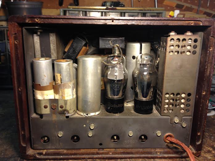

Well I finished up the radio chassis and upon bringing it up, it is dead Icon_sad
No life in the radio at all. There were indications on the chassis of burn marks on the cans and stuff so I am not surprised.

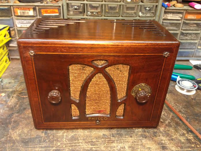

At least it looks nice...
what would be the first thing I would check on a dead radio?
Kirk
switch good ? any tubes light hum ? rectifier tube good
cabinet looks great

1. See if there is high volts across caps 30 and 31. If not, check your 12Z3 rectifier tube.
Then we will proceed.
I'd say make sure you have power coming from the power supply section first.
And don't forget to check those two big resistors, part (29), mounted on top of the chassis, inside that cage at chassis right (when looking at the chassis from the rear).
Both of those resistors are open in my 53C. One of many radios and stereo receivers I have yet to get to.
I dont know how to check for high volts but I checked all the tubes.
1 77 is very weak and the 43 tube is showing up dead (as in 0). When I plugged it in I noticed a spark from the area of the 43 tube. I could not tell if it was inside the tube or not. Checked the area and nothing amiss.
The rectifier is very strong so that rules that out.
Guess what tubes I dont have out of the 2000 I bought... Any guesses?
A 43 and another 77... Icon_rolleyes

Well, you could alwayz bring them to Kutztown.
Next?
Get the toobs. With sparks and 0 on the tester it won't work even if you pray to it.
I was afraid you were going to say that Ron. I kinda feel like the spark came from them Icon_e_surprised
I am getting the tubes now but how does one check those huge resistors?
Same as a regular resistor?
Kirk
A Resistor is a resistor...any resistor is checked with the same Ohmmeter.
