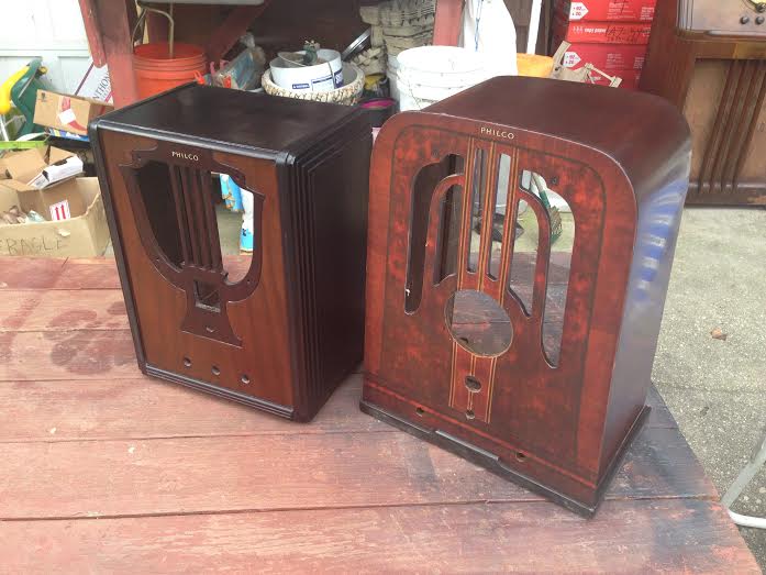

Ok I have finished the cabinet except for waxing.
I found the Radiodaze decal thickness to be much more than the last batch of decals I had. I had to add 6 coats of lacquer and it was still very much outlined. I had to sand and sand and sand to get it to blend.
Wonder if they printed it on a wrong paper?
Anyway I got the cabinet ready for curing. there is a peek at Mikes cabinet too!
Is the decal OK now? Ok I just looked and the pic is too far away. UGH!
I moved it to the center of the line and measured the sides of the cabinet.
The decal may not be perfectly centered since I had issues applying it.
