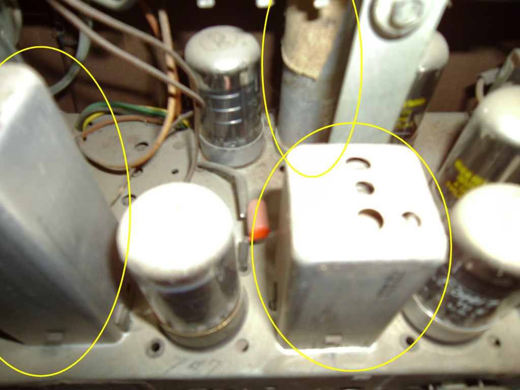

All the paper caps have already been replaced. Are these the electrolytic caps? (The ones circled in the attached pic)
EDIT: The round one you see in the back IS an old Zenith electrolytic capacitor... BUT upon further inspection, it's no longer connected to anything. Makes sense since there are large capacitors right under it (when the chassis is sitting upright) so it has been bypassed with modern caps, but left intact for appearances, I guess.

The two rectangular cans at the front of the picture are NOT capacitors, but most likely IF transformers. The round thing circled in the back looks like a filter cap. Before you get in much deeper, get some books on old radio, and find what various parts looked like in the 1930s and 40s. It will save you time and trouble in the end.
Quote:The two rectangular cans at the front of the picture are NOT capacitors, but most likely IF transformers. The round thing circled in the back looks like a filter cap. Before you get in much deeper, get some books on old radio, and find what various parts looked like in the 1930s and 40s. It will save you time and trouble in the end.
Yes, I intended to. I reserved 2 books through the library's online system last night. I just returned from picking those 2 up -- plus 1 more on the subject of antique radio restoration. plus 2 on reading schematics. So I have lots of reference material for now. Depending which books I like, I may order used copies online. They are nice general reference guides.

Funny I should say it that way. There is what appears to be a piece of thick type of medical tape on top of that one old Zenith electrolytic cap to insulate it from the loose dial indicator panel which is loose due to rotten rubber mounts. But hey, at least someone tried to keep things from shorting out! I wonder if the rotten rubber allowing the mounting bolts to contact chassis frame could also be a problem with it. I will post pics of what I am referring to later on tonight or tomorrow.
Quote:But hey, at least someone tried to keep things from shorting out! I wonder if the rotten rubber allowing the mounting bolts to contact chassis frame could also be a problem with it.

I went ahead and took the pic now. The yellow circles show the bolts that hold in the radio dial face and button assembly.
There are supposed to be rubber mounts on both sides that seem to isolate the bolt and the upper assembly from the lower portion of the chassis. Maybe for an electrical reason. I did notice a piece of rotten rubber, about the size of those, fall out yesterday. I can't remember if that was before or after it blew the tube. I'm going to check at a hardware store for some kind of rubber washers to stick in there on both sides to restore that also before it gets plugged in again.
The green circle shows the bandage tape I mentioned. Icon_lol
