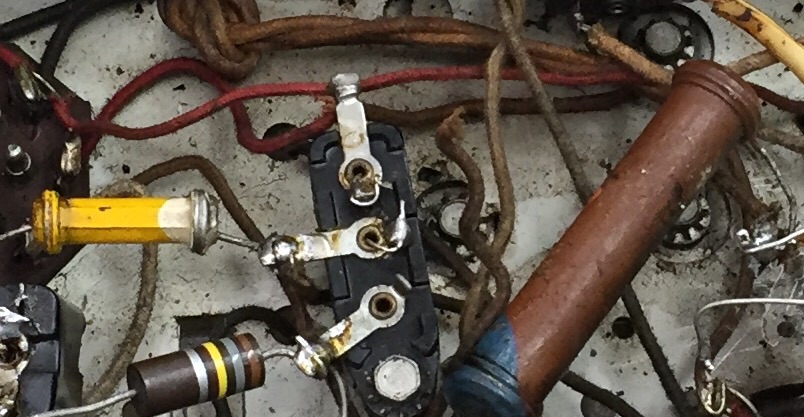

I found a broken/loose wire while looking through the wiring. It comes out of one of the coils.
Slave to an RCA Victor CTC-25
That's not a loose wire. Its a "gimmick" capacitor. It should be wrapped around the adjacent wire as it was in your original photo.
The unterminated wire provides a small amount of coupling capacitance across the antenna coil to increase sensitivity at the high end of the broadcast band.

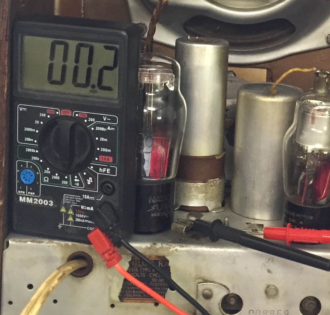

Before doing anything else, check the coils with an ohmmeter to make sure there are no open windings. Open windings in the ant or oscillator coils are probably the most common problems with this type radio.
With the volume control full on and the set unplugged, this is what I got.
Does the resistance reading vary as you turn the volume control up and down? It should show the highest resistance when it is at the lowest volume setting.
The next thing  is to check the oscillator feedback winding. Find the 6000 ohm dogbone resistor ( blue body, black end, red dot ) This resistor is in series with the feedback winding of the osc coil. Measure either end of this resistor to chassis ground. One end should read almost zero ohms to chassis. The other end should measure around 6000 ohms. If you get an infinite ohms reading between both ends and chassis ground, then the coil winding is open.
The resistance did not change depending on the position of the volume control. What is the best position on the multimeter to read resistance in stuff like this? I'm not too familiar with the controls it has.

<I found a broken/loose wire while looking through the wiring. It comes out of one of the coils.
You can see it on the schematic it's #3. It's connected to the antenna coil
I think if you adjust the volume control unless the coils it is open meter reading won't change much. The coil when good it's resistance is so low that it make the volume control look like a dead short.
GL
I tried measuring the blue resistor with a black end and red dot to ground, and on both ends I got 00.0 on the multimeter. It was in the Ohm 200 setting.
