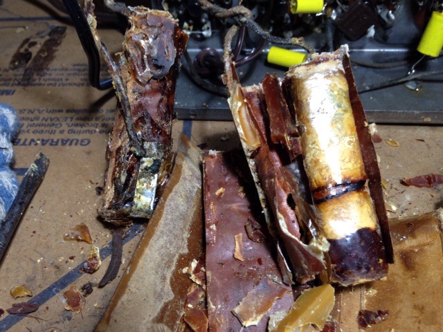

Ok I am at the house and just opened the ecap. There are 2 large caps, each with one wire going directly into the cap. The other wire on each does not go to the cap directly but is attached to a thin metal strip going into the other end of the cap. The one caps wire is going directly into the cap is grounded to chassis. On the other cap the wire going directly into the cap is going to a terminal strip. What should the mfd be for these?

I will follow all the wires from the 2 caps and let you all know exactly where they connect to.

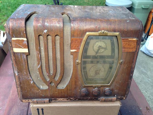

Then maybe your expertise can make an educated guess. I am in love with this POC radio and paid $80.00 for it at K-town so I want it to work great and hopefully look great when I restore the cabinet.

Could that be the strip inside was connecting the two caps' minusses?
Then two neg. wires would be the same, and so chassis would be connected to that solder post the other wire was going to.

No Mike, they were definitely separate caps. I believe the negatives go to chassis for one and the terminal strip for the other but let me check.

 I am still digging thru books and it was a help to see the cabinet .It doesn't look like an Automatic to me but I have been fooled before. I looked thru the radiomania books trying to match it up with no luck.

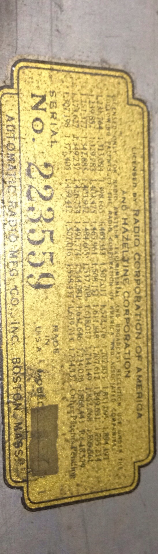

 As yet I haven't found a listing for the 919 and as I said before the 979 used an eye tube so that's out. What does the tag on the chassis say?
                                           Thanks,
                                                    Henry
Thanks for the research Henry,
Here is the tag. Hazeltine radio corp and automatic radio mfg
A guy I know said it is a rare bird. He restores automatics and said all he could find is that the 919 became the 911 in the forties. But the schematic is wrong.

Ok so I just went and put in (2) 20 mfd ecaps and she came on but no sound.
I had it get some stations before but now silence. just a light hum of the speaker.
