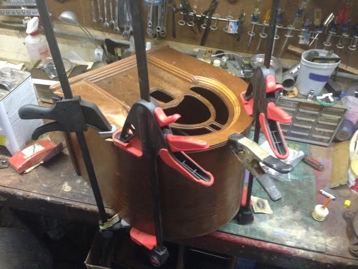

Ok, I have gotten to more veneer repairs today after working on the house all morning.
Only about 8 more patches to go Icon_rolleyes
Kirk
This photo reminds me one of those poor dissected frogs in biology labs.
My veneer repair yesterday failed totally! I forgot to sand the veneer and it had the old finish from the radio I tore it off of on it... Duh!
It came off and I have to scrape and re-glue a new piece on.
Tomorrow I plane the repairs, move on to the rest on the face and then re-attach the face to the frame. Maybe it will dismantle the body to make stripping and Toning easier.... Hmmmmm.....
We shall see!
Kirk
