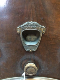

Well if they are globes you hit a home run!
The tubes alone sell for $100+ each.
Non globes can go for $50.00 each so you made back your money right there.
Love to see some pics if you can get front and back

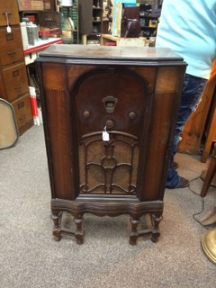

If you look in the very first answer to your post it contains the link to Radiomuseum that has YOUR radio. And says what it is.

I did see that link, thanks Morzh. The picture of the radio wasn't in color so I still wasn't sure if I had the right one. But I'm confident now. Thanks for that link, it looks really informative!

I am not sure what 4 tubes are doing driving THIS big a speaker, but I am sure the engineers had their reasons
In any case it is a nice radio and will be a good performer should it be properly taken care of (and maybe it has been).

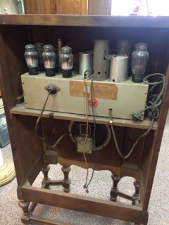

The tag at the shop said Philco radio. But I couldn't find anything that looked like it under a Philco name. I finally typed in the name Slivertone on the front and found my radio.
The tubes in the back say Philco on them so I don't know if its possible to switch the chassis....(the part with the tubes on it?) and the cabinet..(the main part of my radio?) that's why I'm not sure its a true Slivertone.

It is a true Silvertone.
Tubes get weak over time and get replaced. In the time of yore people did not worry too much about who the manufacturer was, a 45 is a 45 whether RCA, Philco or Ratheon.
By the same token in Philcos you will find tubes from whoever.
Tube manufacturer has nothing whatsoever to do with the radio manufacturer. Save the time the radio just came from the factory when everyone tried to install their own tubes (if they made them).

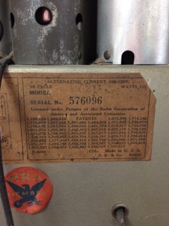

The chassis tag has a faint 1720 stamped on it, so it is definitely a true Silvertone. Well, as true a Silvertone as it can be. Like everything Sears sells they contract out to other manufacturers to make items with the Sears name on them. In the case of your radio it was actually made by Colonial for Sears. Colonial made a lot of radio back in the day for them.
As for the Philco tubes, it was not uncommon to have tubes replaced by a service shop, and they would use whatever brand tubes they had on hand. In this case, the tubes are branded Philco.

From a technical point of view, your radio has parallel push-pull output 45-tubes. A 45 tube sells for $20-30 if it tests good. If they're all there and good, that's most of the value of the radio, just in the output tubes. Ya done good.
Posts: 16,533
Threads: 573
From what I can see two tubes will likely work just fine if all four are not good.
