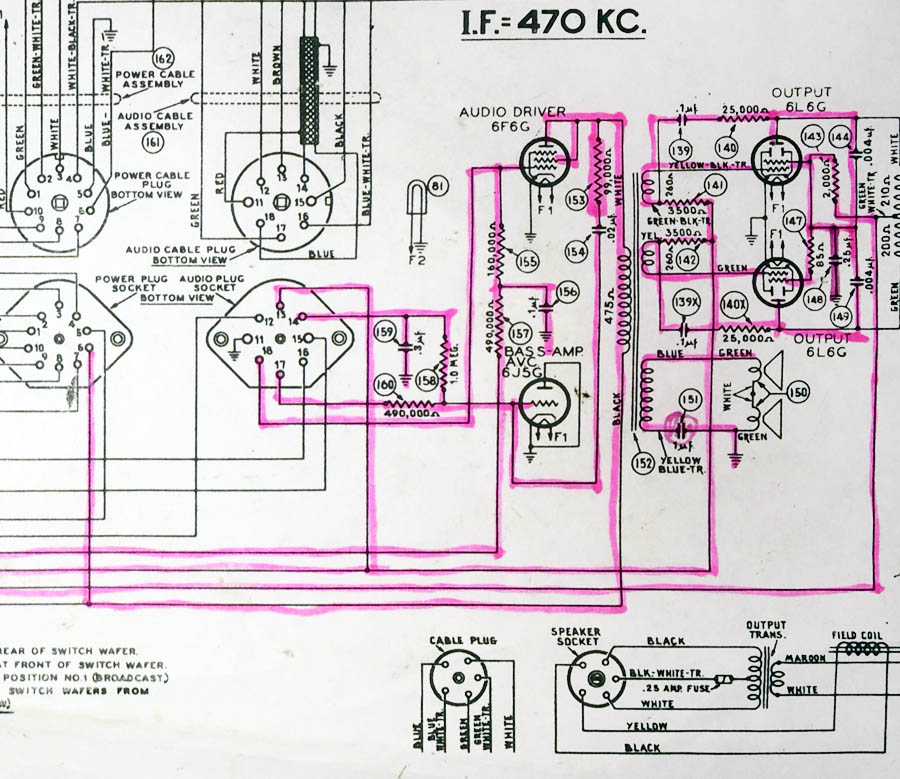

What I need to figure out is why there's no voltage going to the driver tube (6F6), and what other problems there may be in the power supply.

Thanks Morzh. Correct on that. No voltage on the interstage primary. It's not open; reading about 185 ohms. Spec calls for 475 but this difference was discussed further up in the thread; others who had Heyboer make new interstages for them noted the same issue; thicker gauge wire.
Working now to shoot/upload some scans of the schematic. Thank you.

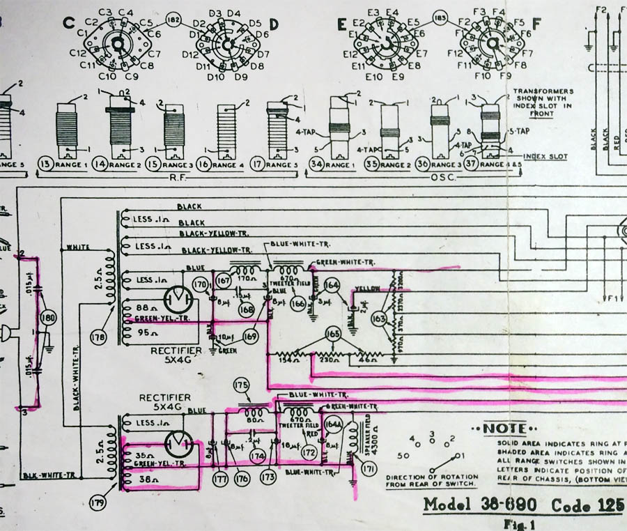

Here's two photos of the pertinent part of the schematic. Sorry for the pink lines; those are areas I'd traced during recap and going over everything.

This. Voltage on the 6L6 power tubes, but none on the 6F6 or 6J5. This is a good indicator of an open interstage primary. But I’m getting continuity across that primary, and just got it back from Heyboer.

I don't see Choke 172. On my schematic, part 172 is the tweeter field coil.
The two chokes I see in the power supply chassis are 167 and 175. Both check out and have the right ballpark resistance. Am I missing something?
Well, let it be the field coil, it is still a choke. Check it. Voltages before and after will do for now.
OK, so I just checked from the black end of the interstage primary to the junction of the 2K resistor (Part 143) and chokce 175 .. If I'm looking at it right that should give me the reading across the tweeter field (670 ohms on the schematic). I'm getting an open here. No voltage on either end.

Choke 175 has continuity, and voltage at same level as 6L6 plates.
You'd asked me to check voltage and continuity across Part 172, the tweeter choke. I attempted to, measuring from the black primary lead to the junction of 143 and the choke 175. I tried and got no continuity. While I got voltage on the side containing the 2K resistor (part 143) I got no voltage on the other side (I measured from the black primary lead of the interstage.
Sorry if that was confusing.
Well your 172 is open. hence the problem. The field coil is bad.
