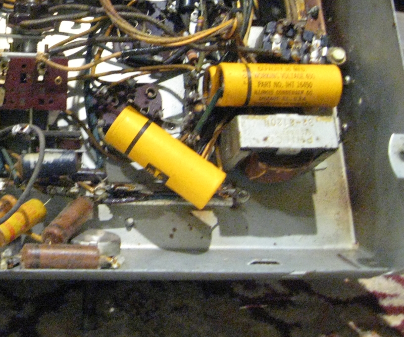

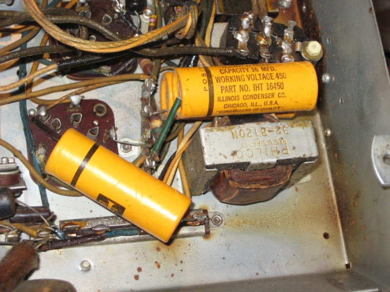

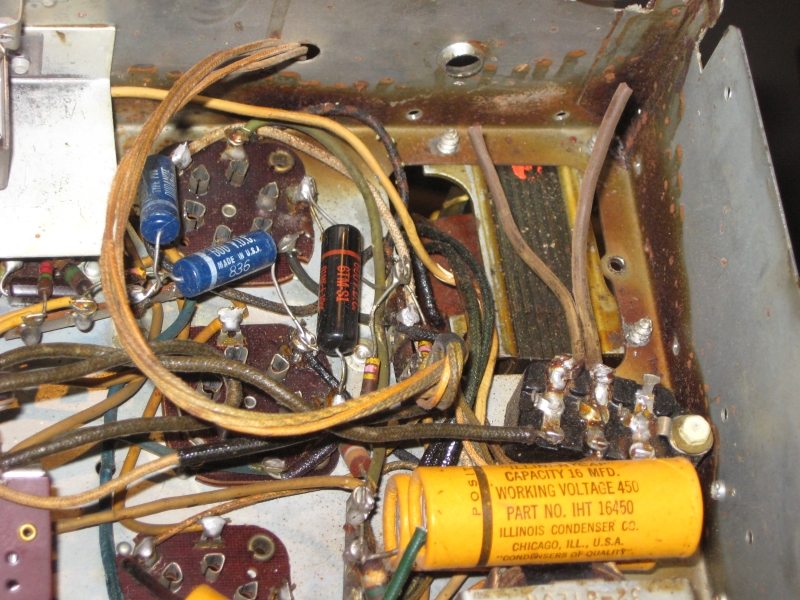

I think things around 84 are not what they aught to be. I got as far as getting some good readings from the audio transformer. But there are three new caps in that area, two grounded at the backlite case (must be #65 in the schematic) and between one end of the candohm and a leg of 84.
I also see some other intruders on the rear 41.
Waddya think?
I am tempted to remove them and try to get this circuitry back to the way it belongs. I'll wager they are part of the power transformer graft. Icon_wtf You can also see how the replacement transformer is cobbled in.
You can also see where that some original caps that were clamped to the front wall of the chassis are gone.
Looks like those are just replacements for the originals. However probably  done 40 or 50 yrs ago. I'd replace them too. Yes the original transformer did take a dump. that's what all that brown is from on the chassis.

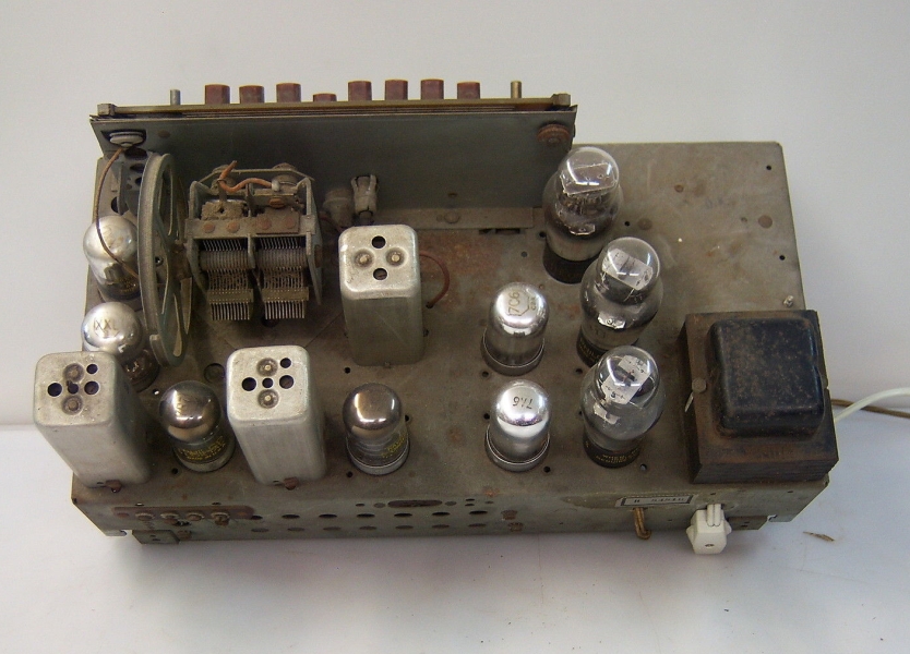

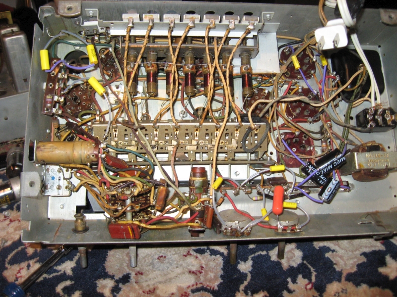

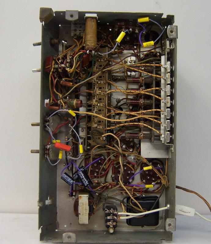

But the output section looks to be the same. It might be an interesting swap, but I think I would just use it for parts. Here are top and bottom views of the 485.

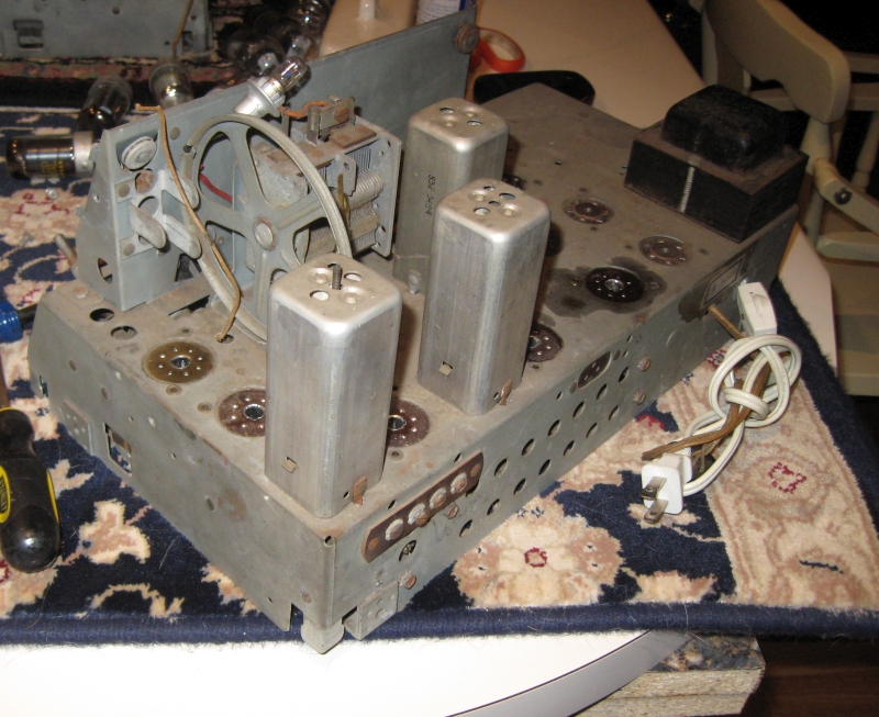

Today, the 41-285 chassis arrived and I am impressed with its overall condition. It was reasonably priced at $28 plus shippiing. The only changes done to it are several new caps, not the neatest job, but easily improved. The tubes are all there, so now I have spares. Still could not test the 41's or the 85. No biggie. The power switch might be donnage, as it has one on the cord. It feels as if it works.
Solid wiring and no rust are it's biggest plusses. Original trans looks very good. Will test it yet tonight.
Did some research and so far, I see no difference between a 285 and a 255 chassis. They both have the additional 7A6 tube and the diagrams are clones. Will learn more as I proceed. 250, of course is the little sister to 255 table top, with this tube absent. 285 is a floor model crate.

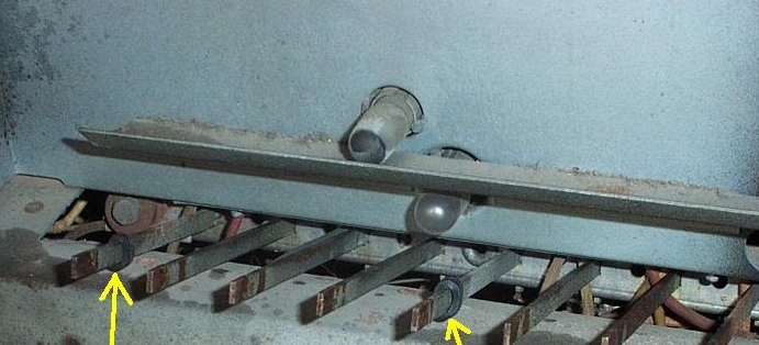

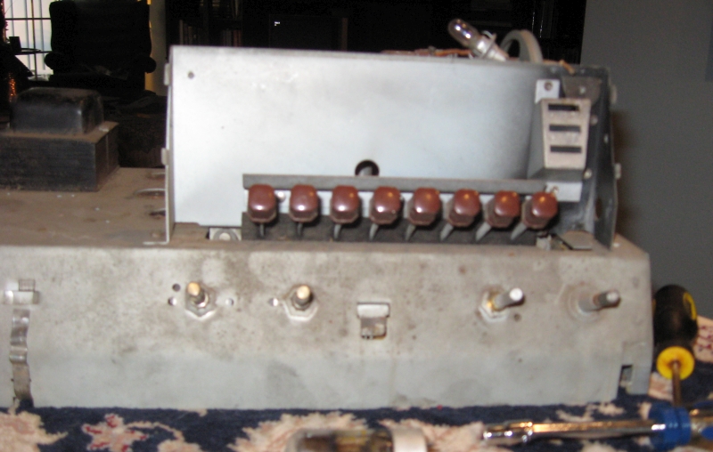

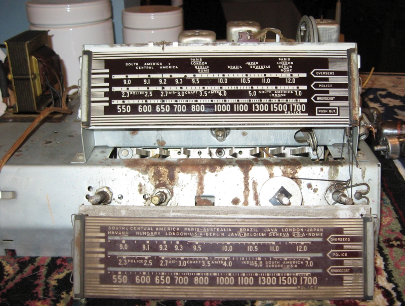

Push buttons are in excellent condition. It has an additional light behind them. I wonder if they went to the wine colored buttons the next year to take advantage of that. The two faceplate lights are separated by a long slender plate. Seems a lot of bother for no reason, but this one will probably show brighter. I am not going to bodge it with the wrong (wine) buttons. I now have two sets to choose from, an old and a new.
Notice in the top picture the difference in the indicator on the 250, which has a single swinging cable operated indicator light. The 285 has three fixed lights (one wire present, all lamps absent). I do not think this is a model based difference. It is date based. According to the product changes at the bottom of the specifications and parts page, one of the later modifications was to get rid of the multiple lamps and go to this "swinging single" arrangement. One giveaway to this is the 285 is not drilled to accept the guides for the cable which is to the far right. The setup on the 250 is in good nick, but I do not see myself retrofitting the later gizmo on by installing the guide and fitting the tuning scale upright (which has the light swivel riveted to it) from the 250.
Also notice the difference in the faceplates. The one from the 285 is in better condition. Despite the presence of the square that says "Push But" on the one from the 250, the light does not swing that low so it is really senseless. Tuning scales are identical, but the mapping is changed, probably reflecting changes in the band usage.
A few tests should tell me conclusively which chassis to use. I am pretty sure right now it's the 285. This radio is common enough that I don't feel obliged to keep it original.
The early production runs of this series of radios had the type of dial lights as are in your 41-285 chassis. There was a dial light for each the 3 bands that illuminated the names of the bands on the right side of the dial. I think there was a fourth bulb behind the push button station labels that would shine through the labels when you were in push button mode. There were (I think) 5 bulbs in all, counting the central bulb for the whole dial.
In later runs Philco eliminated the 3 bulbs on the right side of the dial and the station label bulb, and substituted a single bulb in a swiveling holder that moved up and down to illuminate the name of the selected band. That way they saved the cost of 3 bulbs and holders and a more complicated band switch in exchange for the presumably lesser cost of the mechanical swiveling assembly. The dial changed to include the words "Push But", which were illuminated by the swivel bulb when you were in that mode.

I checked connections, added a power cord and fired the 285 up yesterday. Got glow on all tubes. Dial lights work. Got some weak reception at first, but by the time I reached for a screw driver to tweek the alignment screws, she went quiet. Get chiffs when I change bands. something is not oscillating. When it was working, tone and volume worked smoothly. I don't think the problem is drastic.
