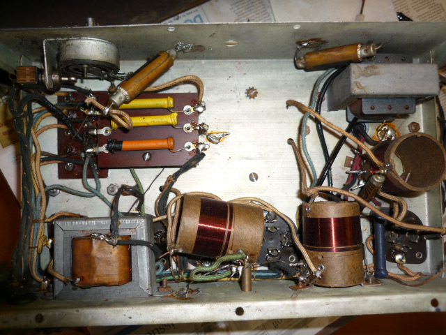

It really sucks not having a print! The output has 4 leads in the picture on the bottom side of the coil on the one lead  goes to the middle yellow resistor on the end which is tied to ground. the other lead goes to the plate of the 71
On top one lead goes to the speaker and the other goes to the 26 pin #2 the 4th tube in line. This lead now goes nowhere?"

Yes, its very difficult without a print, especially if the radio has been modified. It looks like that transformer at the bottom left in the photo is not original, so who knows if it was wired in correctly. If it was connected to the plate (pin 2) of a 226 tube, it might have been a interstage transformer driving the grid of the 71A, not an output transformer, but then why was the speaker connected to it?
What is the transformer in the upper right? is it connected to the 227 detector plate? What does the grid of the 71A (pin 3) connect to?

The one in the upper right has 2 leads so that is probably a choke?
one lead goes to the 227 pin 2
one lead goes to the 26 the 4th tube pin 3
the grid of the 71 pin 3 went to the one side oh the output that is bad and the other lead of that coil goes to chassis

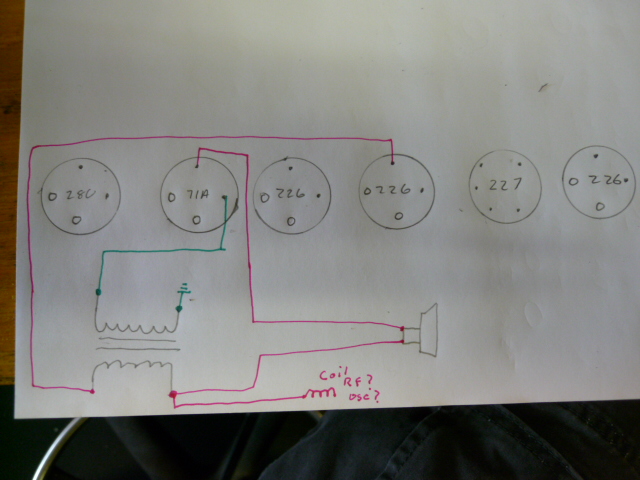

My apologies Mondial
Let me try this
Coil 1-  One lead goes to the 71 grid pin 3 the other goes to the chassis
Coil 2 one lead goes to the 226 pin 2 the other goes to the speaker
Does this layout make it an interstage transformer?
Yes, it seems like an interstage transformer. The connection to the speaker is a bit strange, unless it is the common B+ supply to both the 226 audio stage and the 71A output.
What does pin 2 of the 71A connect to? The other terminal of the speaker seems like it should connect there somehow.
(09-04-2015, 03:15 PM)Mondial Wrote:  Yes, it seems like an interstage transformer. The connection to the speaker is a bit strange, unless it is the common B+ supply to both the 226 audio stage and the 71A output.
Pin 2 of the 71A goes to the speaker.
 the other side of the speaker goes to the interstage and the center coil in the picture. the other end of the interstage coil goes to the plate of the 226

I should have probably drew this and added from the get go.
Yes, the drawing is very helpful. Now it makes sense. The transformer is the interstage between the 226 fiirst audio and the 71A output stage. The common connection between the speaker and the interstage transformer primary is the B+ power supply, fed from the filter cap and 280 rectifier.
There is no output transformer. The speaker is driven directly by the plate of the 71A.
This would be a better choice for the interstage transformer, as it has a higher turns ratio (and is less expensive!)

After some more poking around I think  the P-T124 might be a better choice because the one side that was not open I measured and I got 8.6k ohms which I call the primary  it was the connection to the 71A pin3 and the chassis and the primary on the 124 is 7k and it is rated 5w
https://www.tubesandmore.com/products/tr...Interstage
 Thanks Eric
Eric, you are confusing AC impedance with DC resistance. The PT-124 has a 7000 ohm impedance primary, but this is not what you will read with an ohmmeter. If you look at the specs, the DC resistance of the primary is only about 450 ohms ( 218 +236 ). So if you measured the existing transformer and measured 8.6K, the PT-154 would only read 450 ohms when measured the same way.
Also keep in mind that what you call the primary is really the secondary which is connected to the 71A grid. The primary was connected to the 226 plate and is the open winding.
In any case, the resistance readings and 5 watt power ratings are immaterial. What you want is a step up interstage transformer with a 1 to 3 ratio, which is the standard transformer for driving a 71A output from a 226. While the PT-154 will work with a 1 to 1.5 ratio, the PT-156 is a better choice and will provide more volume.
(09-04-2015, 08:49 PM)Mondial Wrote:  Eric, you are confusing AC impedance with DC resistance. The PT-124 has a 7000 ohm impedance primary, but this is not what you will read with an ohmmeter. If you look at the specs, the DC resistance of the primary is only about 450 ohms ( 218 +236 ). So if you measured the existing transformer and measured 8.6K, the PT-154 would only read 450 ohms when measured the same way.
Yes have to remember that were talking about impedance and not just resistance. I've done a little reading and the 1:3 appears to be the standard. I ordered the PT-156 and will now do the rest of the caps I think I will hang on to these and keep them with the radio as I've never seen this construction before.
