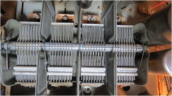

I did notice something stupid i did - the third gang was assembled in "reversed".   I corrected it but i still get a continuity reading of 1.2 meaning grounded to the chassis.  the plates are better aligned and the shaft does not float like it did.  Still no reception.  3 Am in the morning work caused the first problem so i'm leaving this for tomorrow.  I get obsessed working on this stuff and do more harm than good.  I don't know why the 3rd gang is grounded because the other 3 sides are not and i tried to lock it under the rotor shaft, plus  the plates are not touching - proved that when i rotate up so top and bottom are not overlapping.  Well there's tomorrow. at least that is a problem that had to be fixed. Rich

my 4 gang stators to frame measure 307.1 / 307.8 / 3.9 / 10.5 ohms not infinite. I rotate the rotor shaft and the measures are consistent.  the 3.9 is the High frequency condenser. The picture supports the plates are not touching. The mica is clean and in remarkably good shape (window clean).

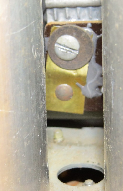

See picture - see the brass 'connector' top to bottom that caused my ground issue - it came this way !  that's a bottom rivet so i believe it is original.
THE REAL FIX is what everyone here kept alluding to, the plates have to be isolated from the stators.  The one odd thing, and i still can't understand, that particular stator had a brass (looks like) plate that 'forced' ground when I screw in the stator. Mike is correct, i measured in circuit (didn't know any better) but i know that .9 or 1.2 is connectivity therefore ground!  That plate WAS grounded because of the riveted plate.  I proved that by completely disconnecting the other screw and it remained grounded.
A couple of weeks ago i when to a estate sale where the former owner keep jars of screws, nails etc. in his workshop.  i saw a jar of washers and for $1 thought they'd come in handy.  I used one of those washers that is hardboard and de-grounded Icon_biggrin my stator and plates for that gang!  Now it measured 49.5 ohms instead of connectivity/ground.
I turned on the radio, misaligned to $%^& (heck) even so, LOUD and clear! When i aligned i had the BEST reception and sound than before!!!!  it is SO clear!
My cleaning spree did something - would i do it again or listen to wiser advice?   Right now, i just like the result.
I owe it ALL to you gentlemen who lent your time and talent.  You pointed me in the right direction - i just had to figure it out.  Look at the picture and tell me is this Plate NORMAL (?) for Philco 90 gangs?  if so, what isolates the plates from the frame - i didn't have a hardboard washer with mine.
