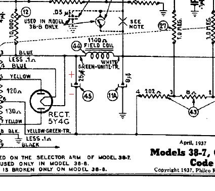

Hey, I'm still looking over this radio (38-8, making sure I have everything in order..
Will someone confirm the polarity of cap #45..
Correct!

Thanks Ron,.. Was afraid I had stuffed the can backwards..
