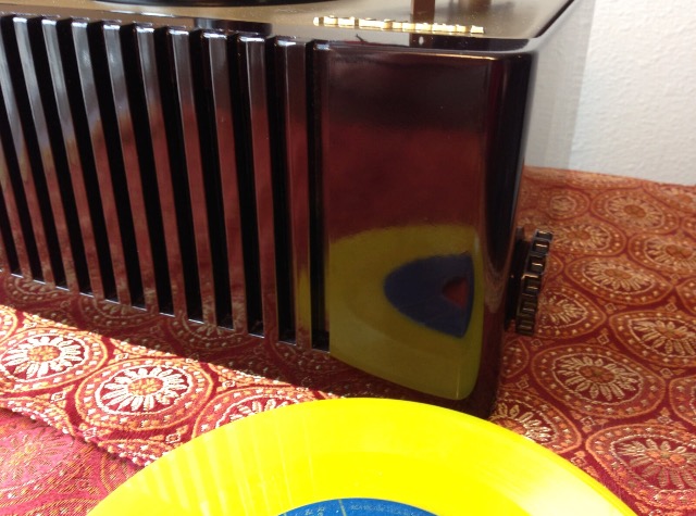

Icon_lolno I like the smell of shoe polish and it doesn't make the cabinet smell for any real length of time.  Once you buff it out the smell is pretty much gone.  Check out this RCA 45 player I did recently:
