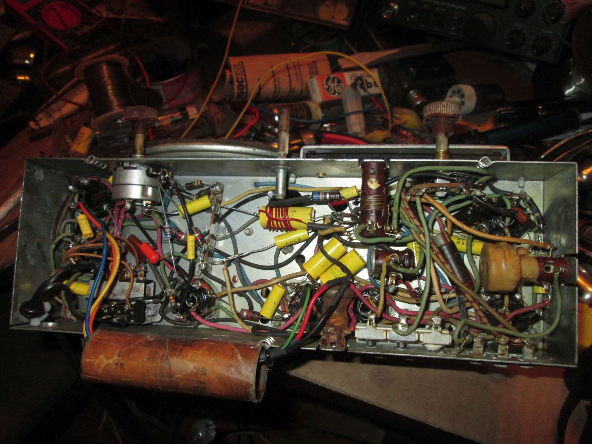

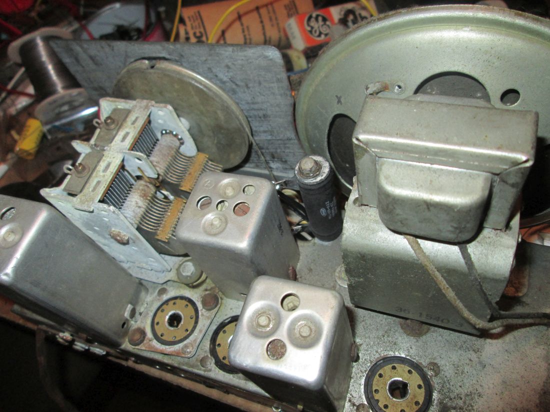

Well for all you kats and kittens that are waiting with baited breath to hear what is happening with the 42-854 the resistor for the filament voltage divider came in the mail the other day. Had a little surprise as I thought I was get just 1 but got 3. So this afternoon I removed the old one and install the new. Thought I'd take a few pics before I power it up and it burst into flames! Also replaced a few pieces of rubber wire and broke the socket for the 1LB4. I think I can repair it, the center part pulled up though the socket and the cover popped off. Off to put the tube back and add some power/watch for smoke!

After I installed #56 still no joy! This getting a little ridiculous!!! Measured the current though the string and it was a little like 60ma. Hmmm. I replaced the 117Z6 w/a silicon diode which increased the voltage a little but didn't what I was hoping for. Went from 8.0v to 8.5v. Then I remembered that it did work before I replaced the caps in the IF and Mixer stages. So by looking at my hand drawn filament diagram (looking at the schematic will give you a headache) I zeroed in on #51 and that thing was shorted. It knocked 1.5v down to .5v. HA HA I found it!!!!!!!!!!. So now on to more troubleshooting now that all the tubes have the correct filament voltage. There is still some amiss as when I touch the ant post I got nothing.

This thing wants to fight me tooth and nail. Both audio stages are working but won't pass a rf signal. If I connect the gnd side of the generator to the chassis it modulates everything with 60cy hum. So I rigged up a gimmick cap ( some twisted hookup wire) to feed in a IF signal. Fed the 2nd IF amp tube plate w/ 455 signal and got a little output from the spkr. Tried the grid and get zip. Plate and sg voltages look ok so I guess it's onward to the 1500 ohm #50 filament return resistor. Come to think of it I should double check the filament voltage on the tube too.
