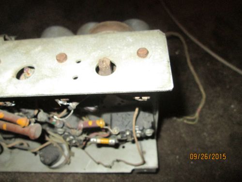

Is your sensitivity control look like the one in pic??? Is it missing the fiber 1/4 nut???
The fiber nut is there. Any adjustment does not produce any change. I have not tried to adjust 11 and 15 yet, only 17 with the fiber nut.
