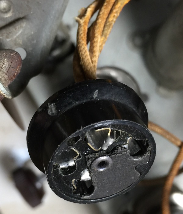

I forgot that the female speaker connector has an issue as well. The fiber washer that holds the contacts in place is broken. It appears to be attached with a blind rivet. What can I do about that?
Thanks,
TerryMSU
Pic ????
(11-27-2016, 08:03 PM)Radioroslyn Wrote:  Pic ????
