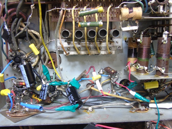

I assume you are talking about the band selector if so I noticed that it has five columns with wire wound around them and one has the wire broken on it so I will take pictures tomorrow sorry for my lack of knowledge I am just learning how to repair radios

this pic has the broken wire

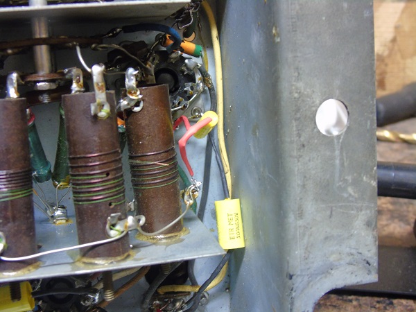

here is another pic

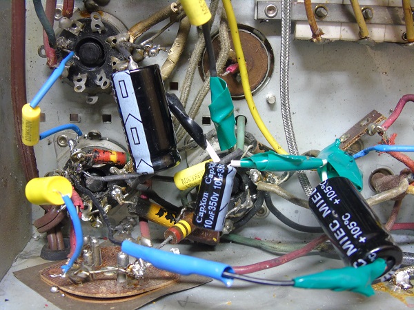

another picture
