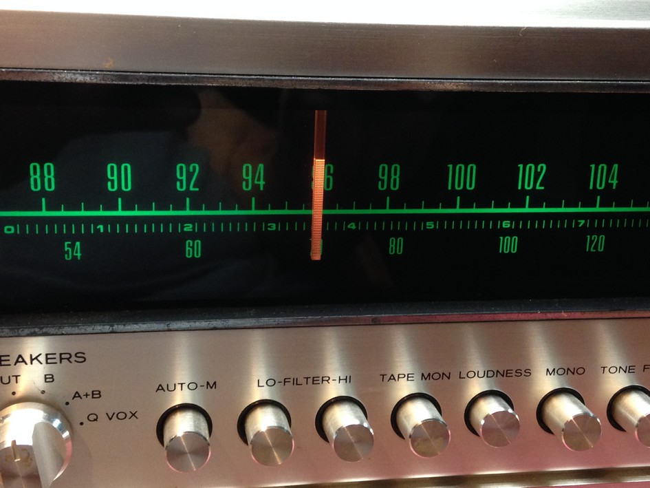

So it is PL8 that is open, which must be the red lamp. When I am tuned off signal, the dial pointer is illuminated. It stays illuminated in this color (it looks reddish in the photo but is actually a light amber) no matter which position the function switch is in - AM, Phono, Tape, Aux - and FM when it is not tuned to a stereo signal.
[Image: http://www.philcoradio.com/images/phorum/STA225_015.jpg]
But as soon as it is tuned into an FM Stereo signal...
[Image: http://www.philcoradio.com/images/phorum/STA225_016.jpg]
...the pointer goes dark.

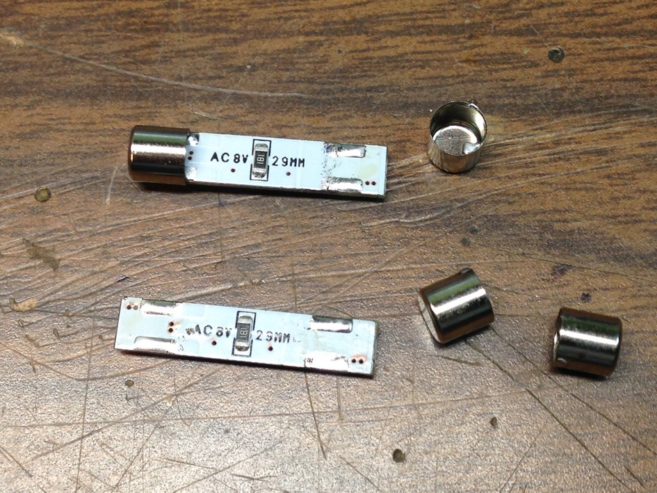

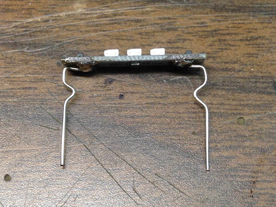

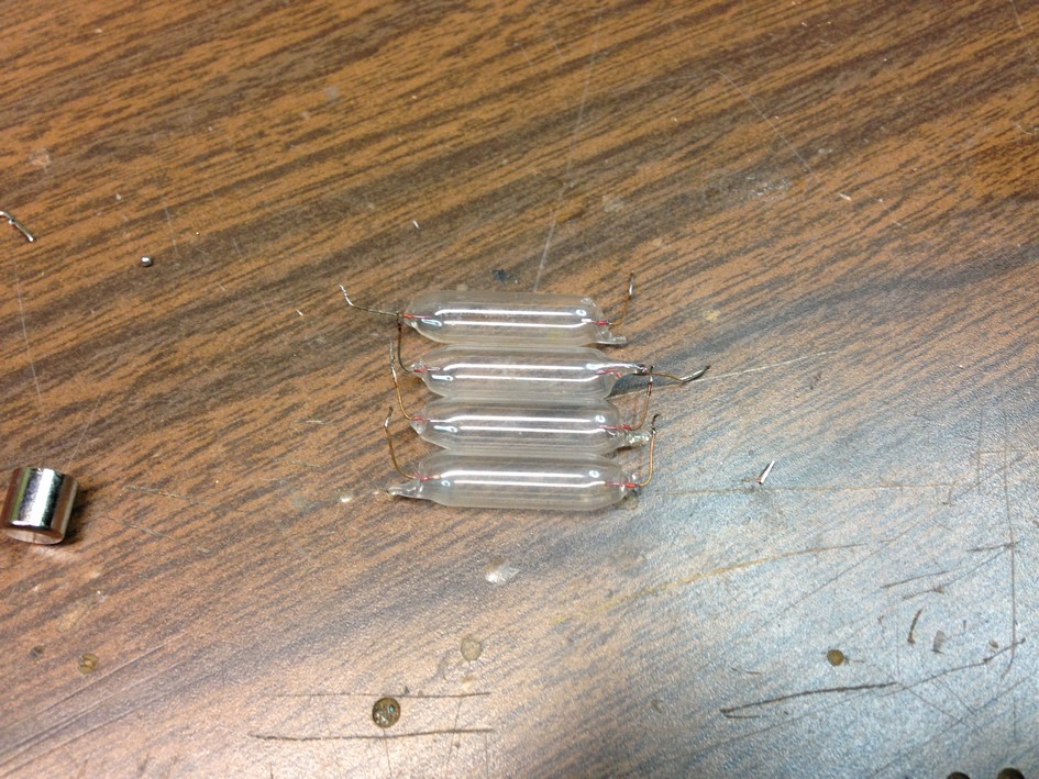

So, having several green LED fuse lamps on hand, I decided to try to convert them to wire leads.
Using a hot soldering iron, I removed the caps from four LED fuse lamps.
[Image: http://www.philcoradio.com/images/phorum/STA225_017.jpg]

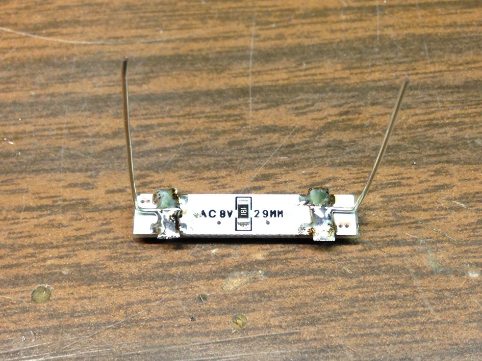

I did not have to solder anything across the two pads on each end, but I decided to do so in order to have each wire centered on each end of the lamps.
Using bits of leftover copper desoldering wick, I soldered bridges across the pads on each end, and then soldered a wire in the middle of each bit of wick.
[Image: http://www.philcoradio.com/images/phorum/STA225_018.jpg]
I bent each wire lead so that there would be a bit of space between each LED lamp and the PC board they were going to be mounted on.
[Image: http://www.philcoradio.com/images/phorum/STA225_019.jpg]
Finally, having already removed the old incandescent lamps, I soldered each reworked LED lamp to the PC board.
[Image: http://www.philcoradio.com/images/phorum/STA225_020.jpg]

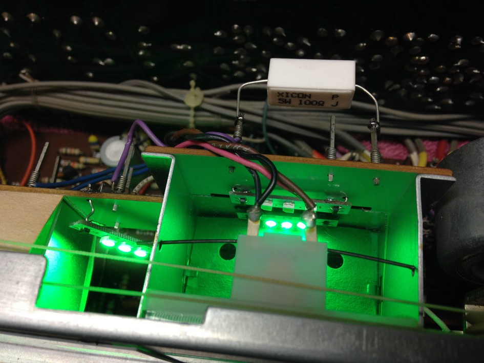

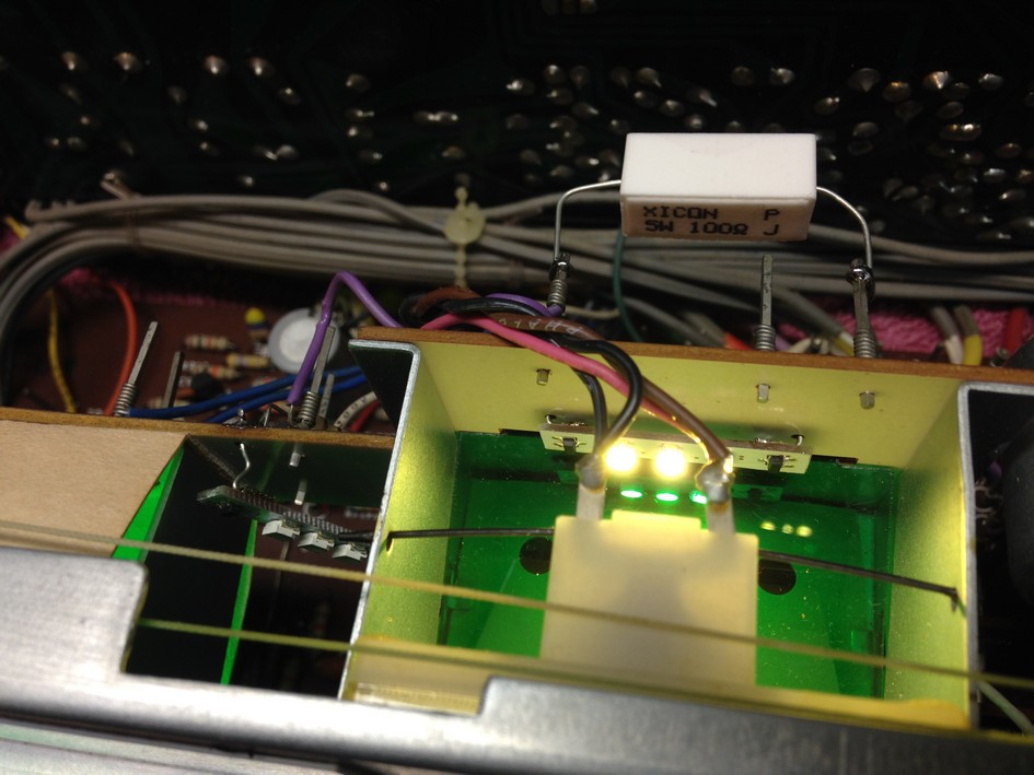

I tried a 100 ohm, 5 watt resistor in parallel with the white lamp and it did not get hot - but at 100 ohms, the green LED does not go completely out.
With 100 ohms across the white lamp, Auto Magic on:
[Image: http://www.philcoradio.com/images/phorum/STA225_022.jpg]
Now with Auto Magic off:
[Image: http://www.philcoradio.com/images/phorum/STA225_023.jpg]
Notice how the green LED below the white LED is still on (although at low brightness)?

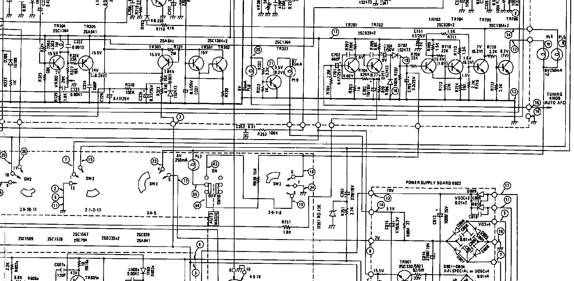

Here's a partial schematic. Click to enlarge it.
[Image: http://www.philcoradio.com/images/phorum...5_024a.jpg]
PL6 is the white lamp while PL5 is the green lamp. TR706 is another inverter, yes? That conducts when TR705 does not, causing the circuit to switch between lamps?

How do the voltage readings on the collectors of TR 705 and TR706 compare to those shown on the schematic in both auto-magic positions?
As far as I can see, the circuit should work fine with 300 ohm resistors across the leds for PL5 and PL6 unless there is a problem with one of the transistors being leaky or not completely shutting off. Also check the base voltage on TR705 and TR706 in both auto-magic conditions.
There is another lamp PL7. Did you replace it with a led and bypass with another 300 ohm resistor?
Yes, PL7 is the Auto Magic lamp; and yes, replaced with green LED fuse lamp converted to wired lamp, and 300 ohm resistor. It works fine.
I will check the voltages at TR705 and 706.
Posts: 1,114
Threads: 14
Joined: Feb 2013
City: Irvington, NY
OK Ron, I think I see what the problem is.The lamp driver circuit is very poorly designed.
TR705 which lights the green lamp is never completely turning off. With the incandescent lamp, a bit of leakage through TR705 makes no difference because it takes 250 mA to light up, but the LED is much more sensitive and still lights with a low current.
TR703 is what controls TR705. TR703's collector switches between 1.6 V and 15.5 V, and supplies base current to TR705 through R711. The problem is with 1.6 V at TR703's collector, there is still enough voltage at TR705's base to turn it on, leaving the green led lit. The solution would be to decrease the resistance of R715 to less than 1K, which shunts the base of TR705. This will form a voltage divider with R711, so that even with 1.6 V at the collector of TR703 there will be less than 0.7 V at the base of TR705, insuring it turns off completely.
Before you do anything else, connect a 1K resistor across the existing 2.7K R715 and see what happens.

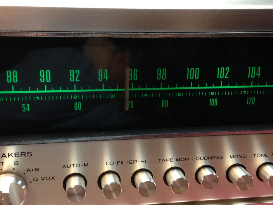

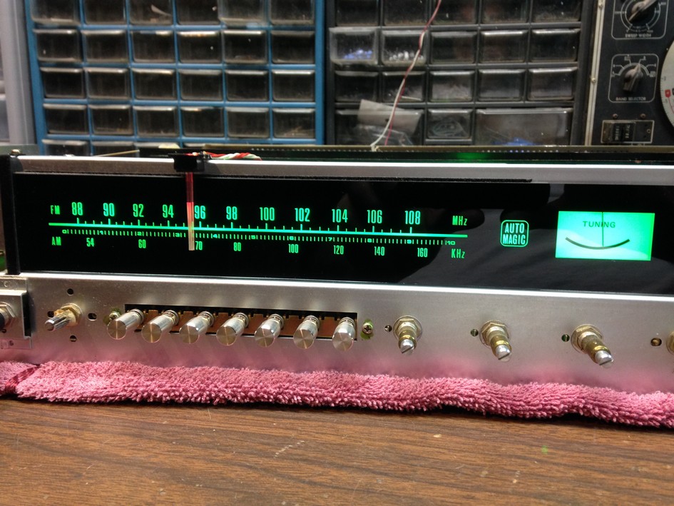

In FM mode, Auto Magic on:
[Image: http://www.philcoradio.com/images/phorum/STA225_025.jpg]
In FM mode, Auto Magic off:
[Image: http://www.philcoradio.com/images/phorum/STA225_026.jpg]

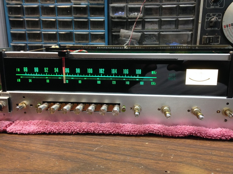

The new LEDs really make a big difference in how the dial looks.  And I did replace R715 with a 1000 ohm resistor.
Strangely enough, the red (FM Stereo) pointer lamp has now decided to start working.
I won't be putting the front panel back on until the new dial pointer lamps arrive. I've decided to go ahead and convert them to LED as well.
