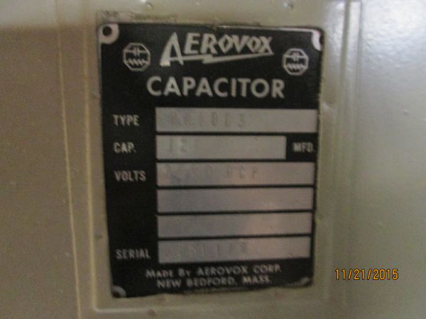

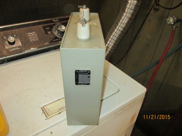

So if I hook this puppy across the line all the noise will go away, neighbors will thank me for cleaning the line for blocks and blocks???
or
Will I be cursed for years for make the hood go black??
Don't know how many nf it is but it's 12mfd @ 3500v np.
The hood won't go black as 12uF is not that much of a capacitance and is an equivalent of 220 Ohms load except it is purely capacitive, and the current itself will be 1/2 A.
And this is one of those cases where "the size doesn't matter" Icon_smile
(12-28-2016, 05:44 PM)morzh Wrote:  The hood won't go black as 12uF is not that much of a capacitance and is an equivalent of 220 Ohms load except it is purely capacitive, and the current itself will be 1/2 A.
So abt 50wts.
Do thing improve if I add a few hnys in series with the cap?? I may have a 5 or 600 ma choke around.
I don't see why unless you are having problems. Yes LC filters are good if used correctly. Henries? Depends what noise it is.
