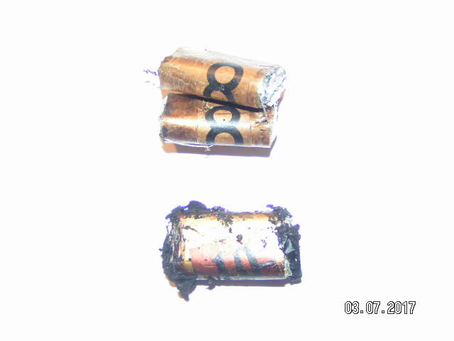

Thanks Terry,You are very helpfull. I did get my cloth line cord and fuse holder . I think I am going to put a polarized plug on the end , just a two wire plug and follow the one at the common side which is the larger terminal and hook the other end to the capacitor block where the old wire is now. The hot side I will put the fuse inline and solder that side to the on off volume switch where the original wire is.  I did my capacitor block gutting . Was real easy using the heat gun for a few seconds. Now to buy the new capacitors.
I have my schematic and picture diagram Page  8  of 27 showing block capacitor as #35 in the picture. On page 8-28 of the parts replacement page it list #35 as having two capacitors. That is right . But this part show that they are two .015
capacitors. The ones I pulled out of my radio are marked with a large 8 on them. What do I replace them with.
Just go with the values listed on the schematic/parts list. Don't know if there is a reference to the numbers 8 or 10 as printed on the original caps.
Don't pay attention to marking. If it says 0.015uF - this is what you need.
The block where the no 10 came out of , the parts list shows a .09 capacitor.  I guess the 10 being next value higher would have been ok. But I will stick with a .09.

(03-07-2017, 07:11 PM)ohiobill Wrote:  The block where the no 10 came out of , the parts list shows a .09 capacitor.  I guess the 10 being next value higher would have been ok. But I will stick with a .09.
.1mfd remember.
