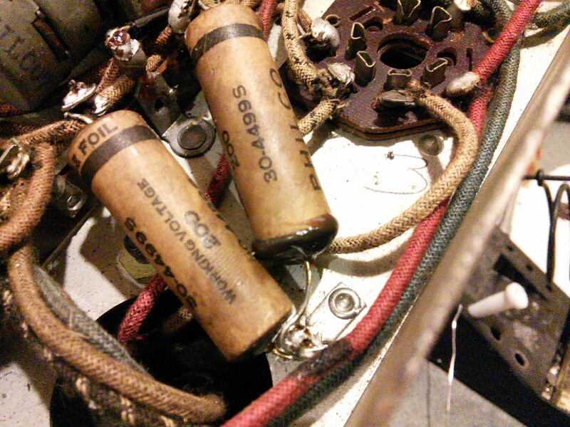

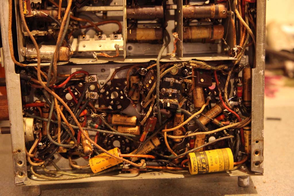

Looking at the diagrams and the available photos of other folks I see the tubular electrolytics that are present in my chassis are not there normally, so they were likely added at a repair facility (I can say, added very neatly so I think it might've been an authorized shop though the caps are not Philco but just maybe Philco no longer made those that would just fit). The single cap I could see on other photos are the on on top.
So no need to buy tubulars. Will get by can electrolytics when rebuilding the power/amp chassis later.

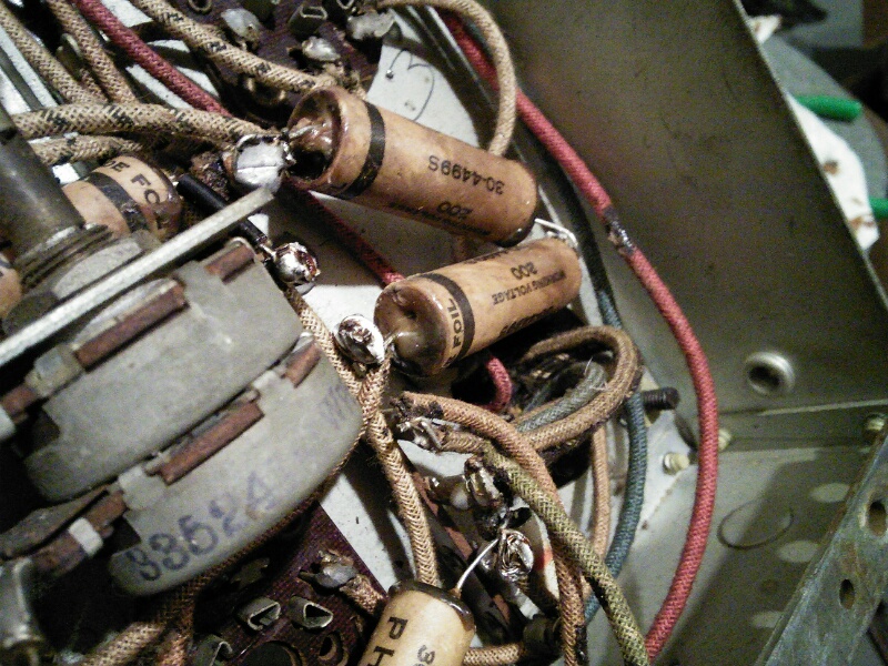

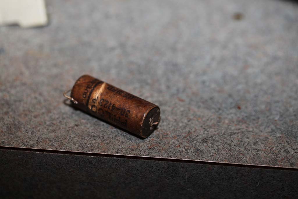

These caps have been restuffed.
I reused the wax. The wax darkens after re-melt but still look natural, plus there are darker wax used sometimes.
I put some hot glue first and then melt the wax on top of it when it solidifies.

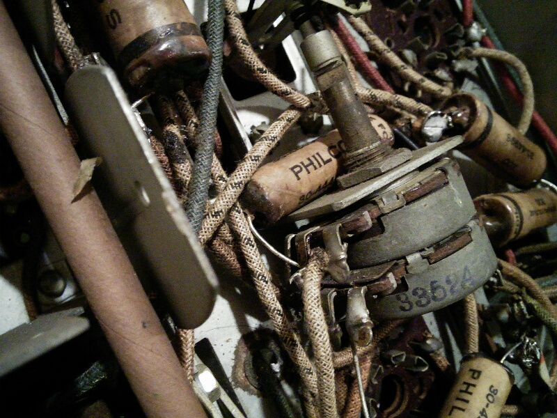

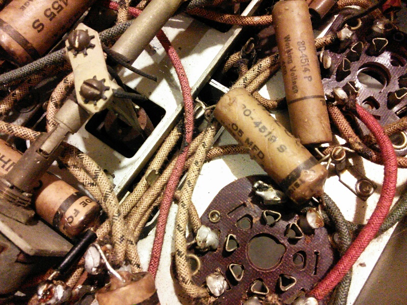

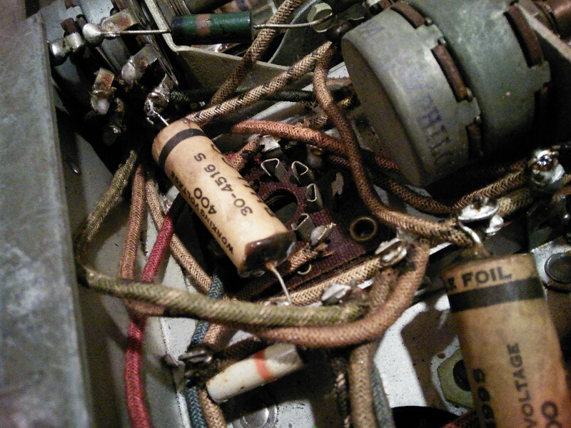

These have not been changed yet.

Did left and right sides of the chassis, now the only caps left are in the RF chassis but there are few and they are well within access.
Changed 3 resistors - most are within tolerance.
Different caps use different wax and some use light colored one that doesn't melt as quick as the brown one and then foams a lot.
Not going fast but the wax re-use slows down the process.

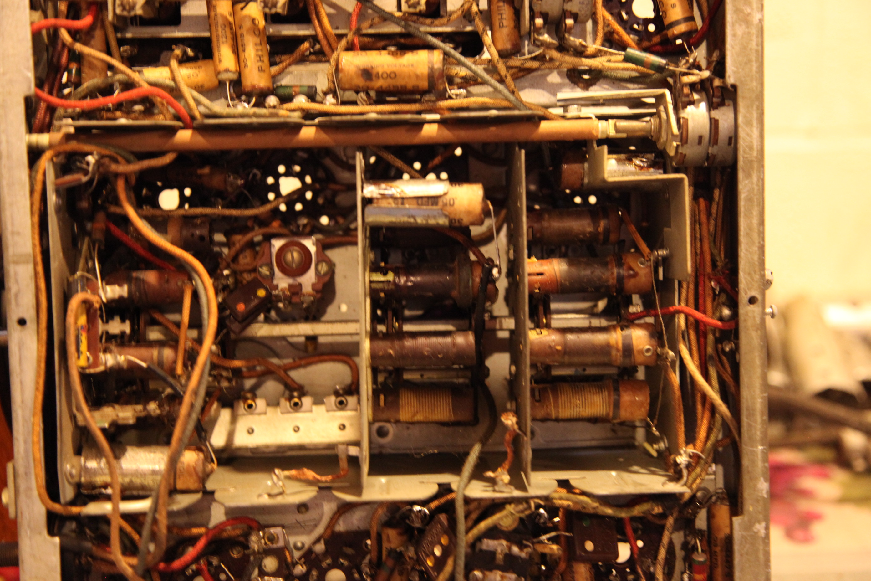

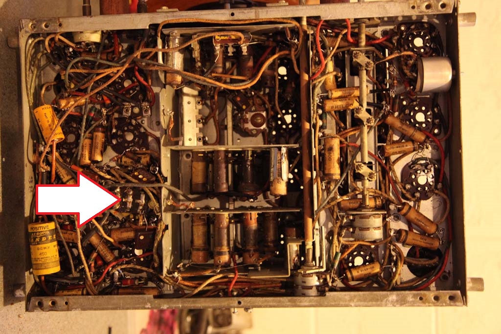

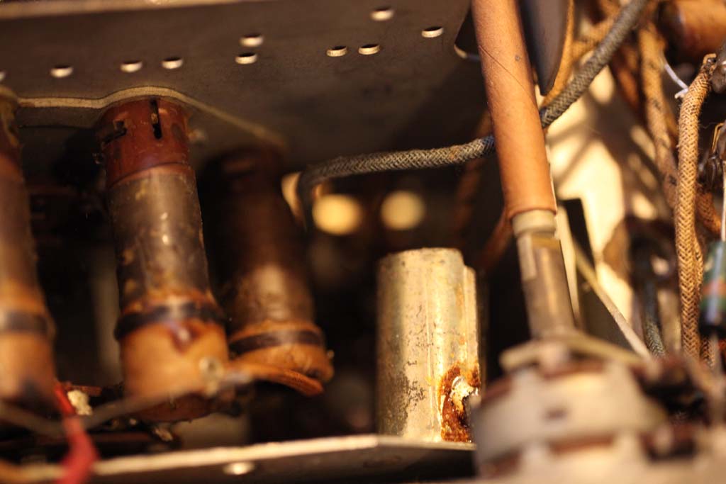

Today there was the central part, which is also the RF chassis, and it has three caps encased into a cylindrical screen, which in 2 out of 3 cases made the replacement a bit complicated.
Here is how it went.

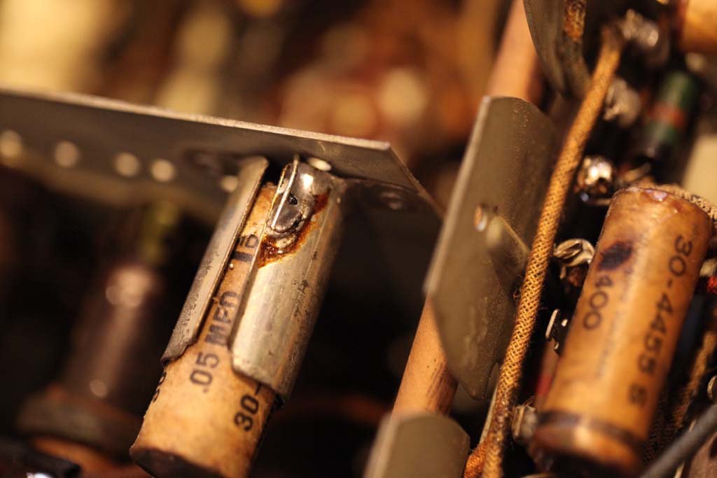

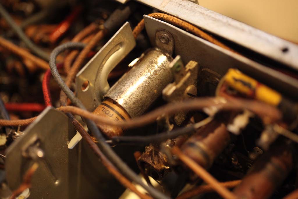

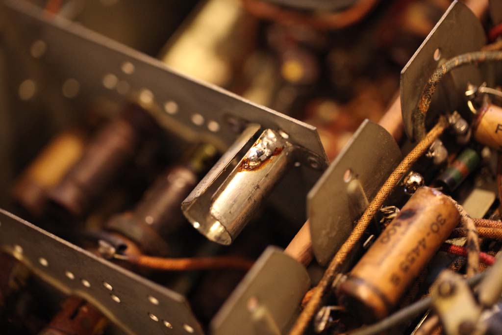

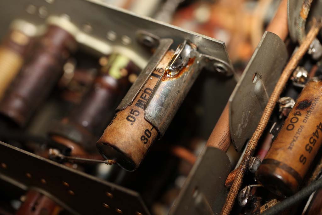

This is the cap in the screen I am talking about. Nothing special: the wire soldered to the screen is easily unsoldered and the cap, after a little warming up with a heat gun to loosen the wax (6-7 seconds) is pulled out.
Then restuffed, potted and put right back. E-Z.

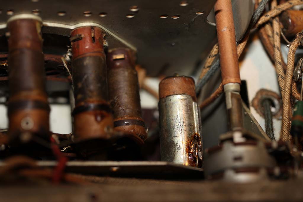

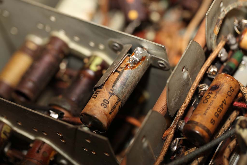

Now comes the second one. This is sandwiched between the two chassis plates separating the RF chassis into sections. I could not pull it out as the space is not enough.
Luckily, the split in the cylinder and the fact that the plates flex a little allowed me to tilt the cap at the angle enough to pull it out.

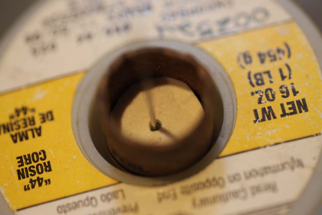

Then I put the cardboard protection disks I cut to size inside the cap after gutting it,
...and pot it with hot glue first, and then with the remaining original wax.

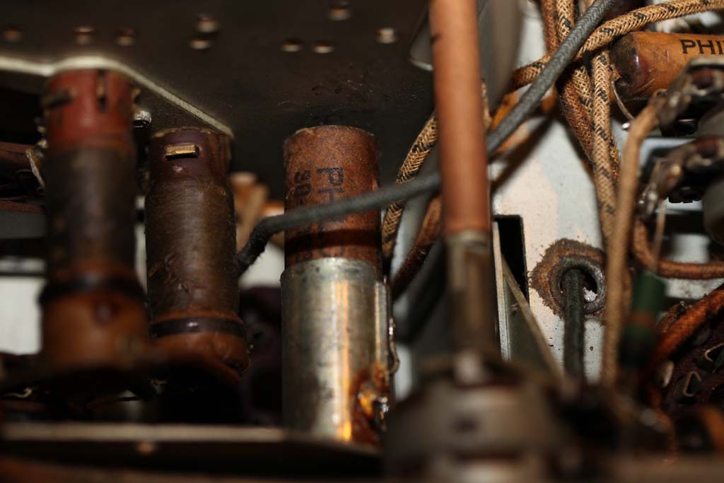

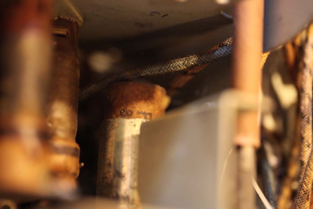

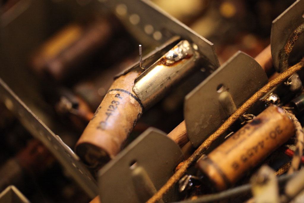

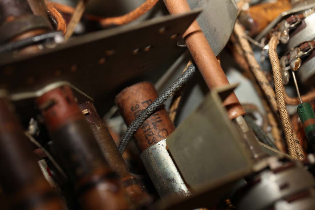

But wait....there is the last one. And it is hindered with more stuff than just the chassis plates, let alone sitting deeper inside and close to the corner.
It is under the stiffness bracket. And a wire goes over it which is pretty taut. And the slit in the cylinder looks towards the wall. As if all before was not enough.

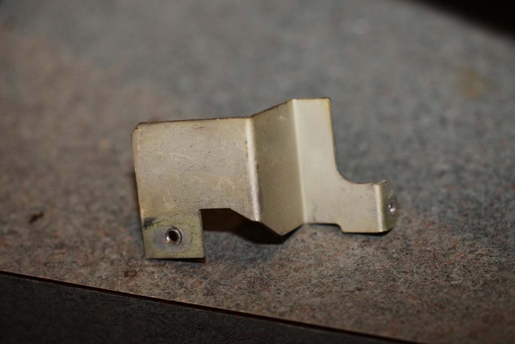

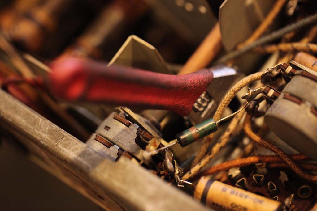

So we start from removing the bracket. The screws are not well accessible but luckily they are 1) standard Philco hex and 2) I just happened to have a small tiny adjustable wrench in my very own pocket.
The bracket's out.

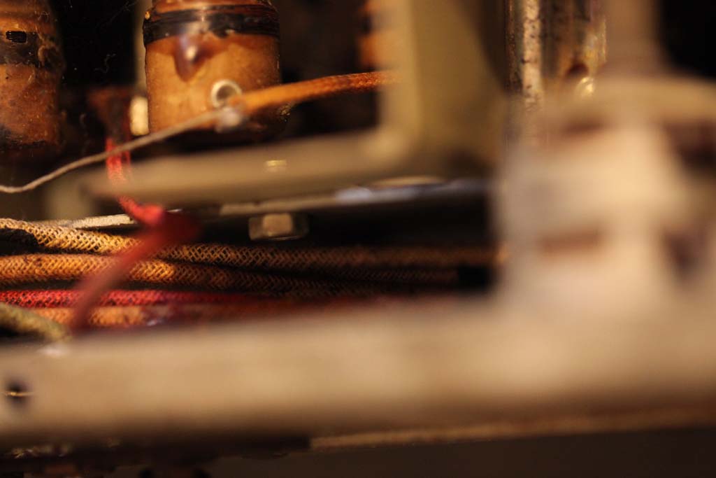

And the wire that was going over, very taut, is unsoldered.
So its end over the cap can me moved.
Then (drum roll, please!) a bend of the cap and a bend of the plate above and....the cap's out!
Gutted. Potted.
And (with some difficulties...it is always easier to pull it out then to push it in) it is back in it's cilynder.
And the wire is soldered back.
Then the bracket is put back. Putting screws back was a challenge...good thing I have small hands.
Whew!

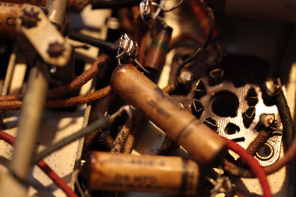

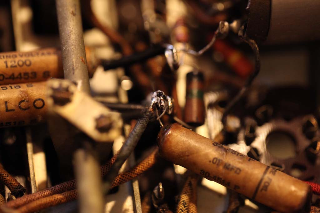

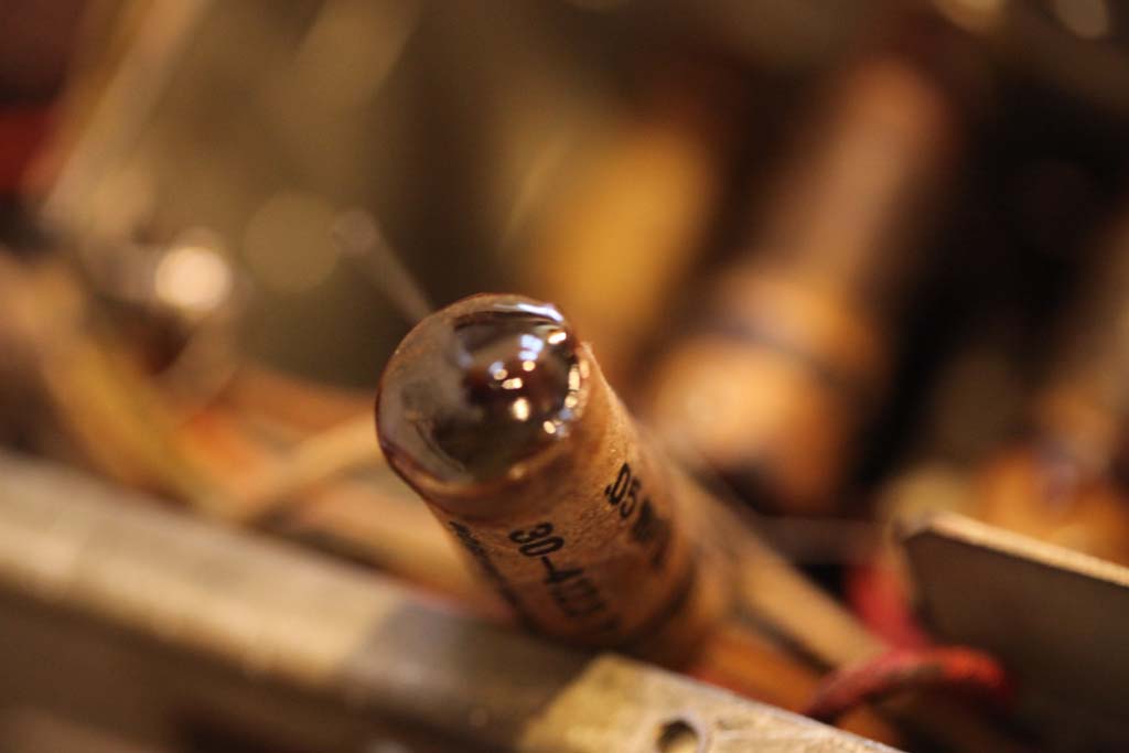

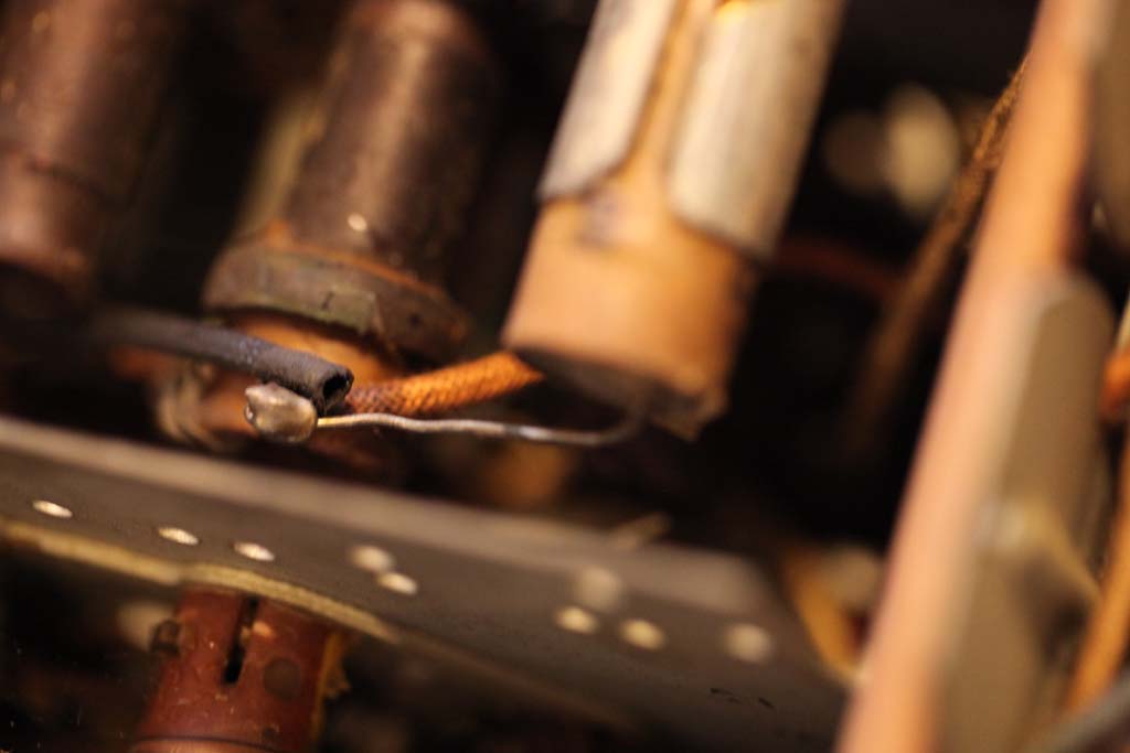

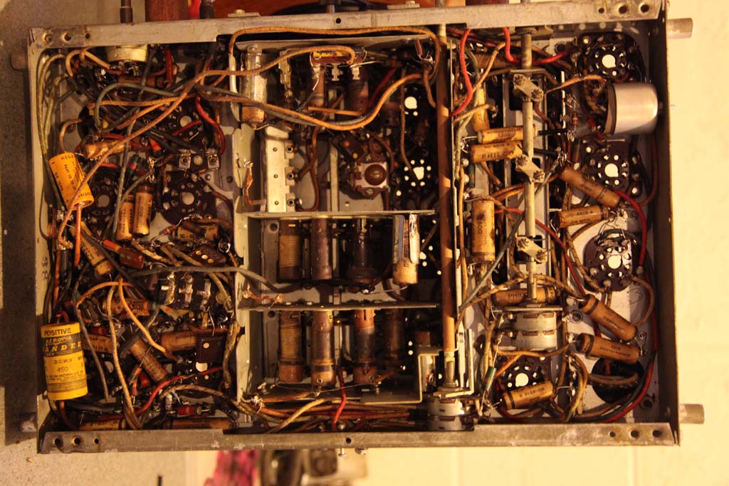

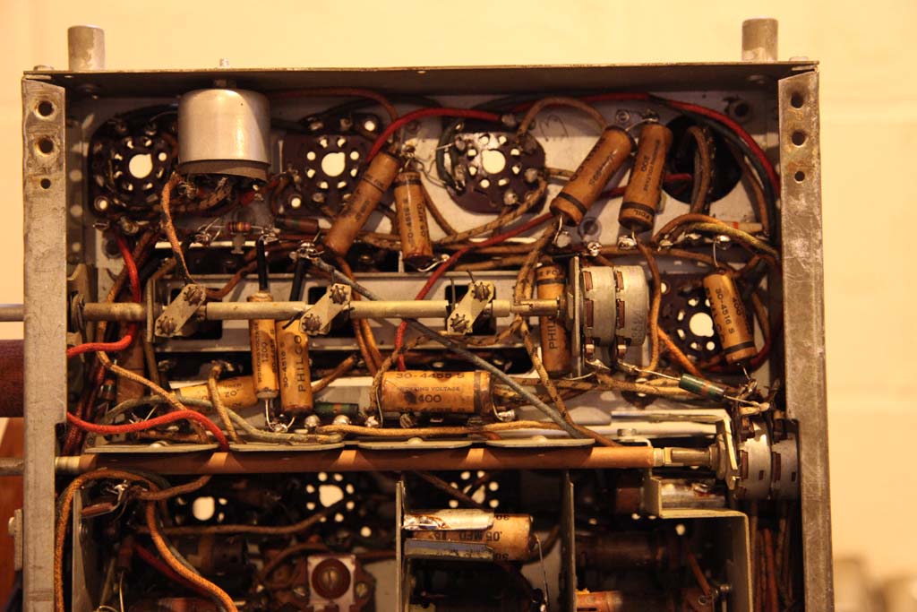

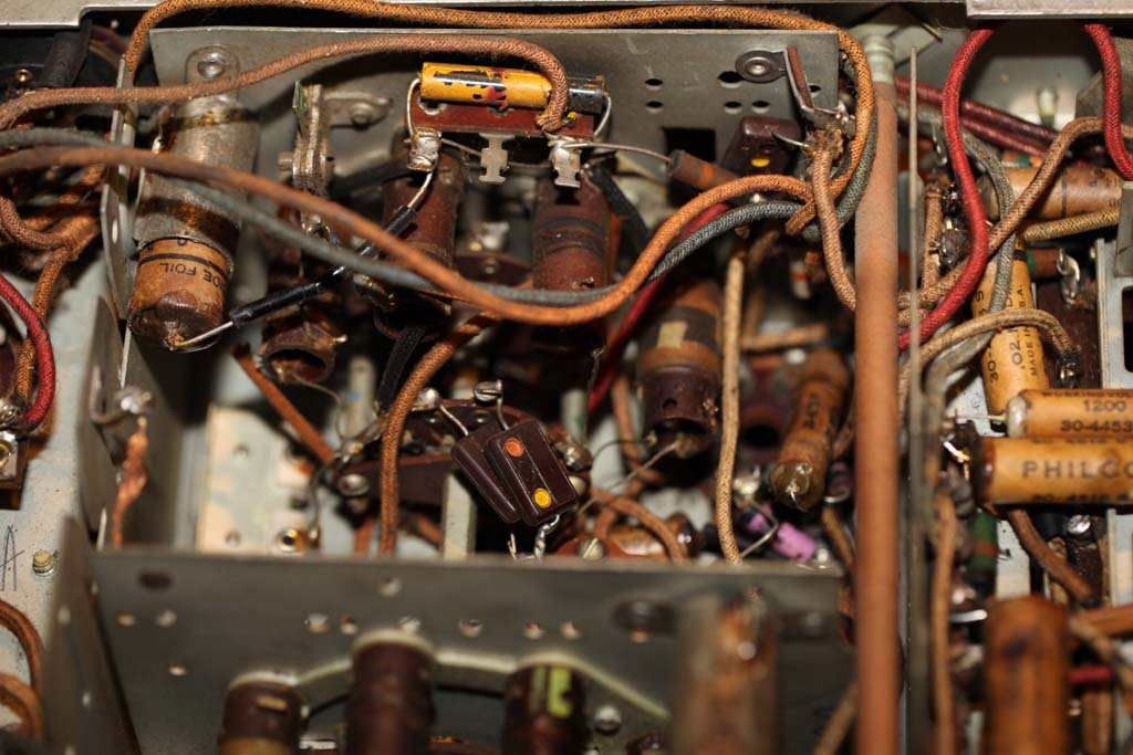

Some views after the recap.
