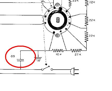

Did you ever replace the 1626 tube that was showing a short (or swap in a diode)? If you found two of the Electrolytic caps bad I'd yank out all 4 caps and replace them with 2 caps of (close to) the right rating. You've also got that .05 cap that could be going bad.

You can also try disconnecting one end of the .05 cap that is going to ground.

I disconnected the .05 cap that was from one side of AC to ground No difference..

I disconnected the .05 cap that was from one side of AC to ground No difference.....
